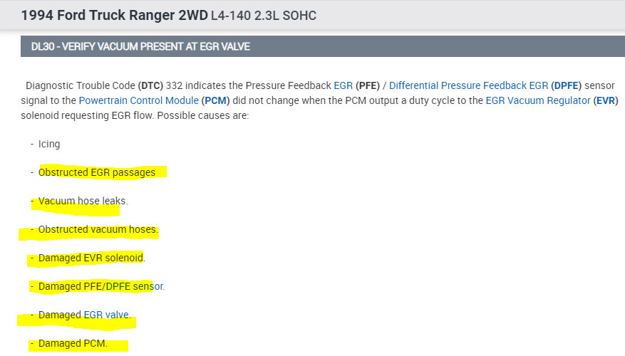

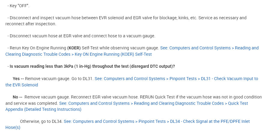

Based on the codes you have; I am going to focus on the 332 which indicates a restricted flow. That is based on your description. The other code, 335, is related to the EGR pressure sensor voltage.
So, here is what I suggest. Take a look through the directions below. They are the diagnostics specific to code 332. If the diagnostics need to go further based on what is provided, let me know.
Let me know what you find.

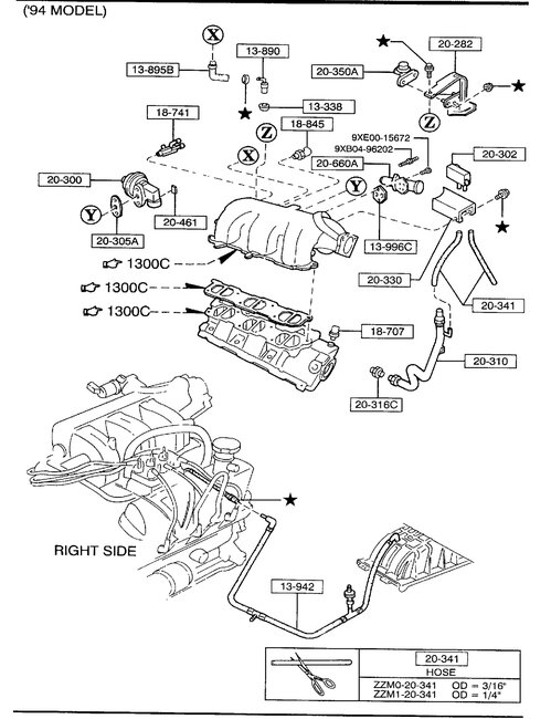

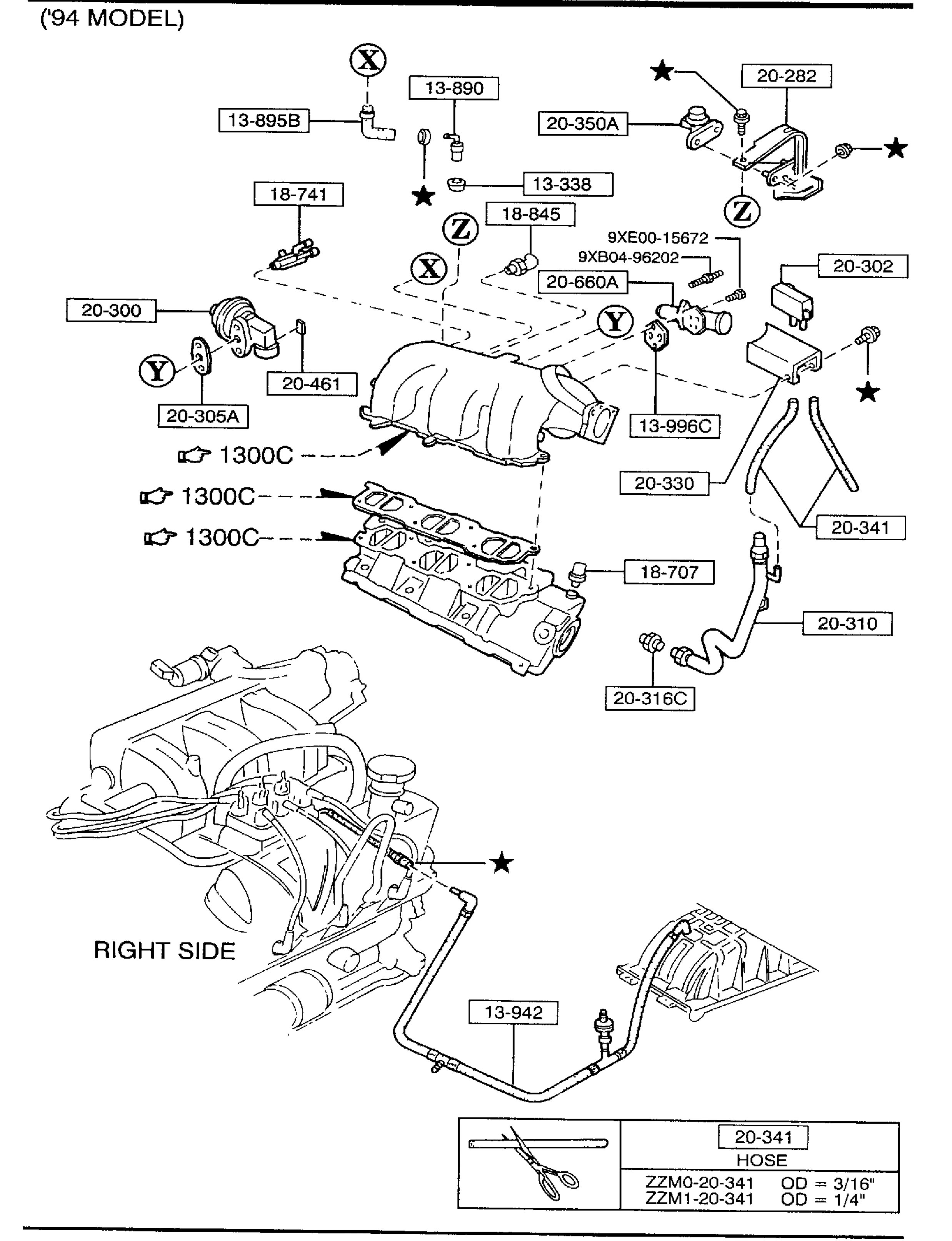

Would the attached be a good example of my EGR system?
With the ranger running and at running temperature. If I was to apply vacuum to the EGR valve and if there is no change or it does not run rough, is that a indication that the EGR system has no or very little flow?
David
Friday, January 20th, 2023 AT 2:48 PM
  • 110,192 POSTS
If you apply a vacuum, you are opening the pintle valve on the EGR and it should affect how it runs. If there is no change and the EGR is good, then you have things plugged up.
Also, the pic appears to be accurate.

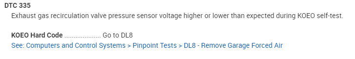

Hello, I see I stated that the 335 code was new. Which isn't true, I did not finish that sentence because I was laughing to hard after reading a question I had asked of you earlier "Can I snake the EGR tube in place and not hurt the Cadillac converter or anything else?" Where I implied I could take a GMC product and convert it (to what I don't have a answer for that yet!) See what happens when I'm left unsupervised! LOL! CATALYTIC CONVERTER . . I was not aware I had a Cadillac!
I won't blame you if you block me! LOL!
Do you have any code 335 info by chance?
Thank you much for the support and patience, David
Monday, March 13th, 2023 AT 10:43 AM
  • 110,192 POSTS
Dave,

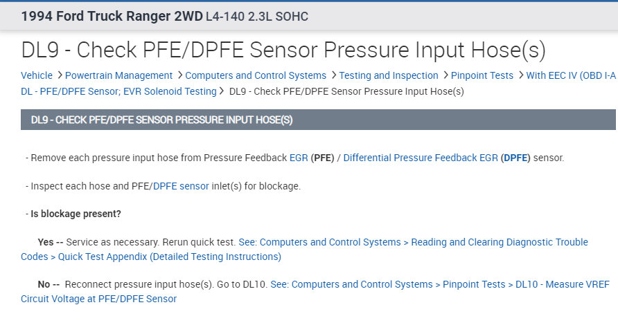

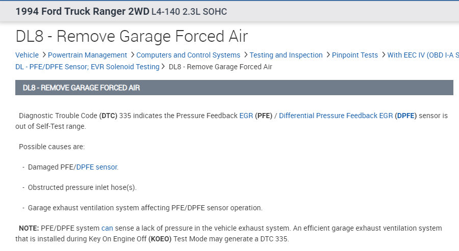

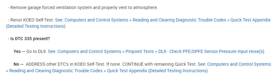

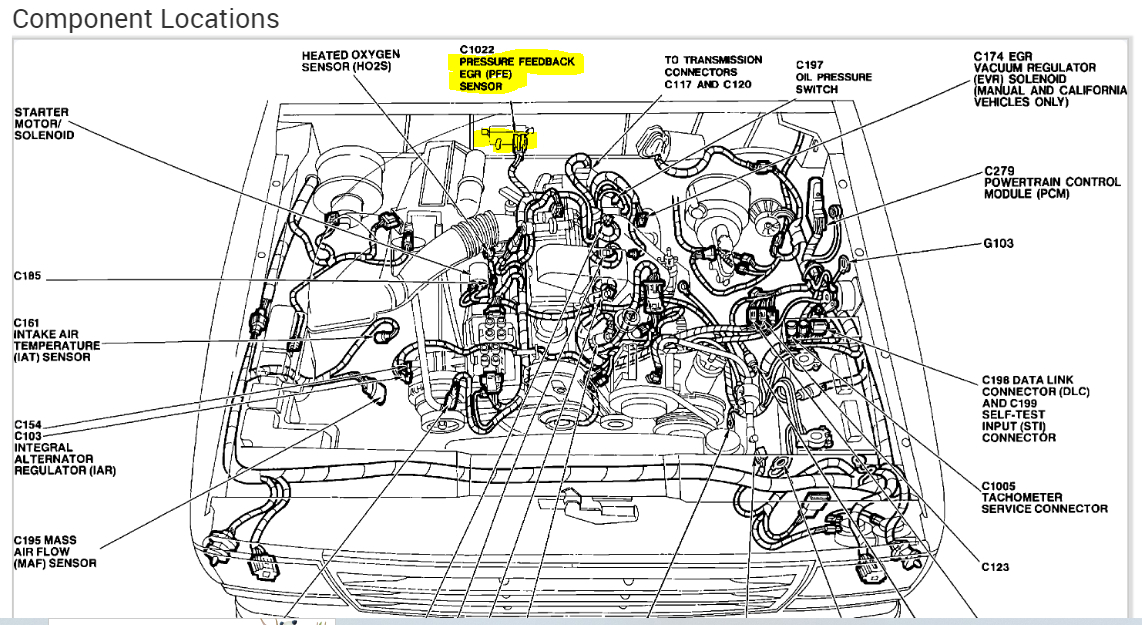

I would never block you. LOL, I do have information related to the code. If you look at pic 1 below, it provides the definition for a 335.
The remaining pics are the start of the diagnostics specific to this code. Take a look through them and let me know if you are comfortable performing them. If you do, let me know the results so I know which direction to go.

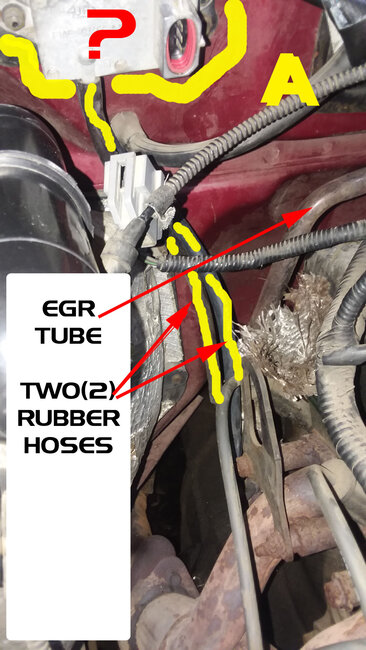

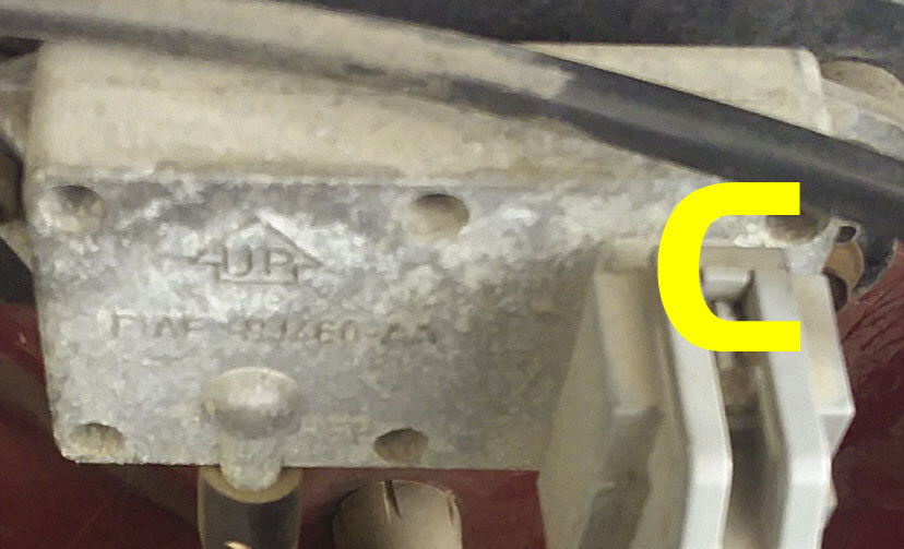

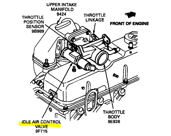

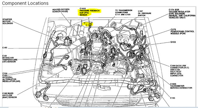

HELLSAFRAID
  • 9 POSTS
Hello Joe,
Attached is probably more evidence that you do not have to worry about me being able to steal your job anytime soon!(More like this century)

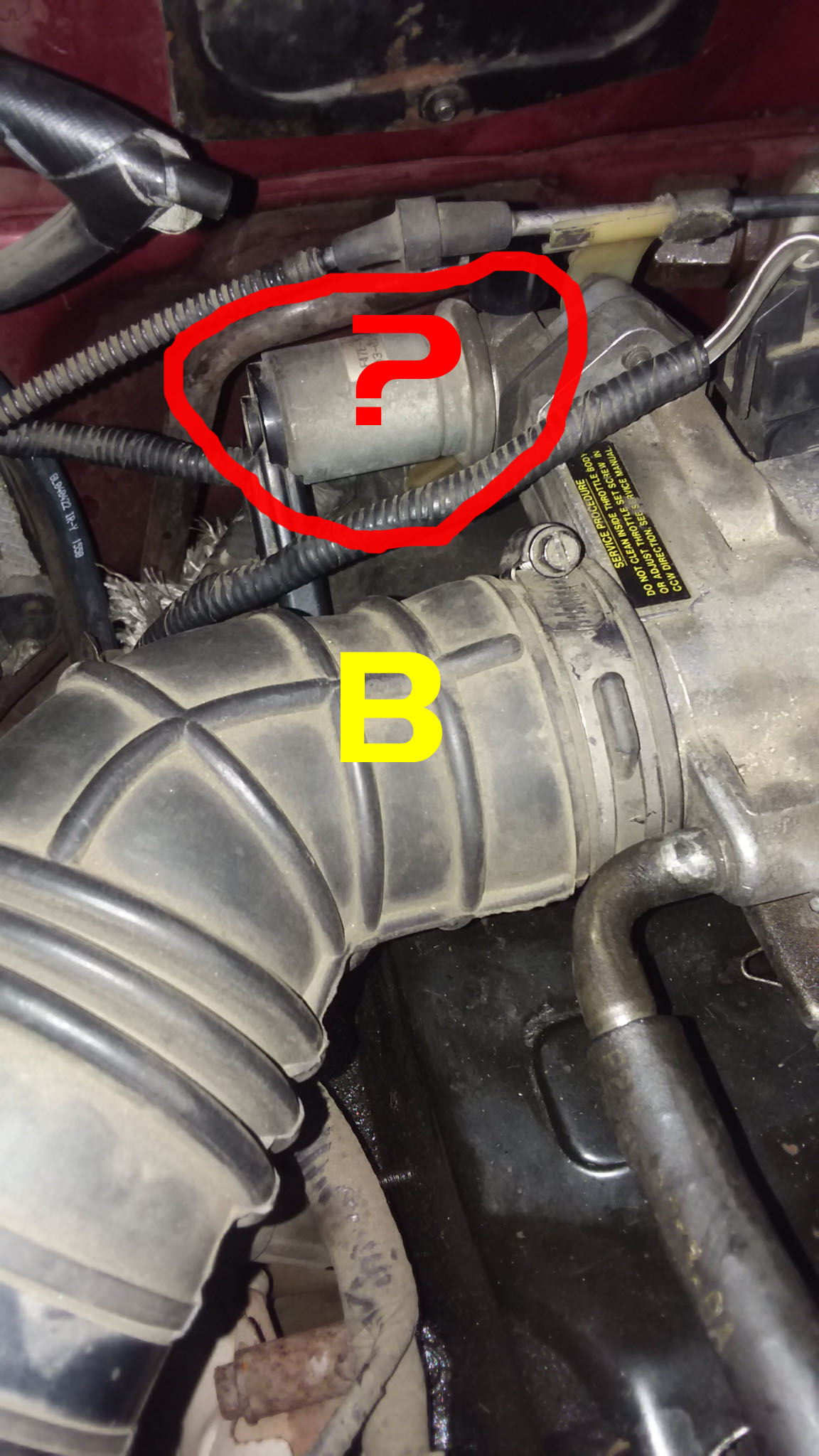

A; is "A" pic the PFE or the EPT? It had 2 rubber hoses that connected it to the EGR tube down where the tube went into the exhaust manifold and was powered. It was blocked when I tried to look through it but when I pushed a skewer through it, it was a very thin blockage, although enough to block light.
Just curious what this "B" was (Haynes manual has been helpful at times, like on windy days it keeps other info from blowing down the street! But most of the time it keeps reminding me that I should have gotten a manual specific to California 1994!)
C; The part # Due to wear and tear on my eyes and on the component
this is what I came up with
P1AP-9J460-AA
OR
F1AP -9J460-AA
I look forward to your response and thanks again, David
Thursday, March 16th, 2023 AT 1:16 AM
  • 110,192 POSTS
Pic A is the PFE. See pic 1. Letter B is the idle air control valve (IAC). See pic 2 Letter C has me lost as well. Where is it located? Is that an electrical connector on the right? If you follow the vacuum hose, where does it go?
Thursday, March 16th, 2023 AT 7:17 PM
HELLSAFRAID
  • 9 POSTS
Joe,
"C" is just a close up of "A". The PFE has two hoses and one had a thin blockage to where I couldn't see light through it but there was no resistance when I pushed a skewer through it the second hose had no blockage what so ever but was newer and out of a different material and falling apart! So I fixed it the right way . Duct tape and bailing wire and 2 zip ties (no I did not do that I ran over to orielys and got a reaming there for what they charge they must of sold me a gold braided hose!) Of course I'm hoping it was that thin blockage but it sure did not feel like much at all.
Tomorrow I will drive it to the DMV to get more one day passes (2)I have tried for more passes per visit but they will only give 2 at a time So I will drive the 40 mile trip to get them so I can drive it sat and sun and that should be enough time to find out if that resolved it or not? Should I clear the codes first before I drive it?
As always, much appreciated! David
