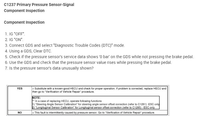

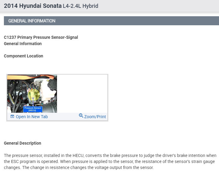

Good evening,
I got a code on my vehicle listed above.
C1237 primary pressure sensor signal.
Can you help me to determine the problem?
Should I change the HECU?
Thanks
Sep 10, 2019 at 12:21 PM
DANNY L
  • CAR REPAIR CONTRIBUTOR
  • 5,648 POSTS

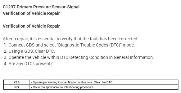

Hello, I'm Danny,
I've attached step-by-step diagnostic instructions below to check first before replacing the HECU. Hope this helps and thanks for using 2CarPros.

The problem was solved and then reappear after about 15 miles.

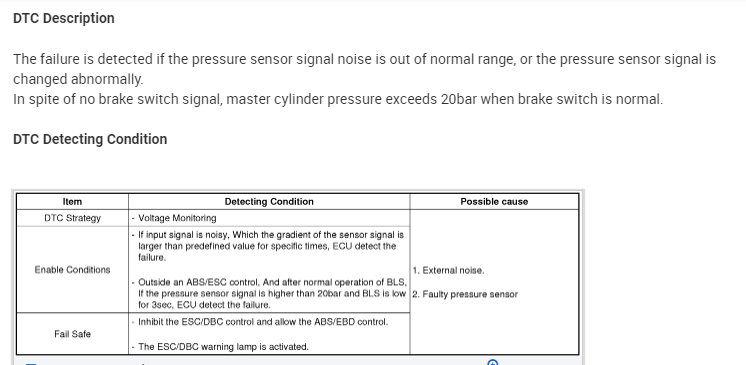

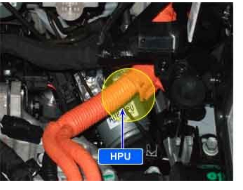

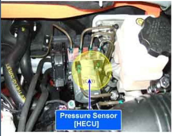

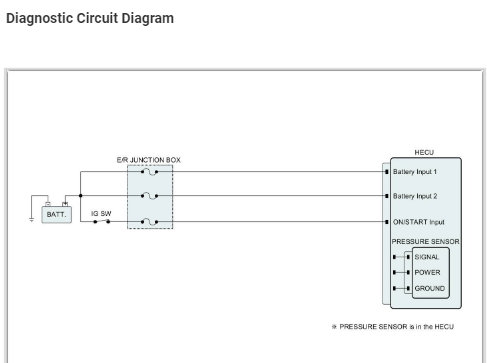

It sounds like the ABS pump is out or the sensor is bad.
C1237 Primary Pressure Sensor-Signal
General Information
Component Location
General Description
There are three pressure sensors in HPU (Hydraulic Power Unit). They each measure high pressure accumulator pressure, booster pressure, pedal simulator pressure. AHB ECU (Electronic Control Unit) uses these measured values to monitor AHB operatoring status and control AHB.
After replacing AHB ECU, pressure sensor calibration and PTS calibration are essential.

HASANABUSINI
AHB ECU replaced, the problem resolved.
