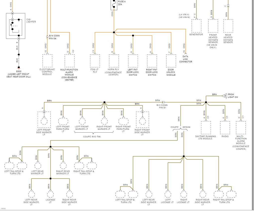

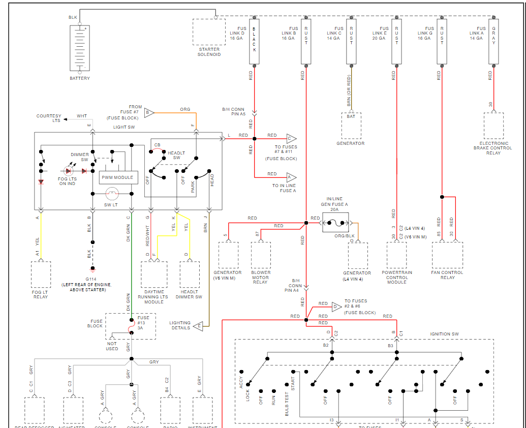

I am trying to rewire the fuse block that melted down on my car Ruby. She's a good ol girl and I know she's got another 200000miles left in her. Nobody else believes her. I can't read wiring diagrams, but I did take plenty of pictures to reverse wire her. Is there not a Chilton's, Mitchell or Haynes printout of where each colored wire goes you could send me? And is there such a thing called 5 and drive? Like engine compartment side of C100 Battery +/- ground, alternate +/-, or starter, water pump? And is there any sealant I can use on fuse block once I get everything wired up? And I've noticed some of the pinouts have the number 12 on them, (battery?) some have 19 on them. Some say PEC, PCM,P?? What does this relate to? Thank you

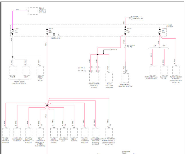

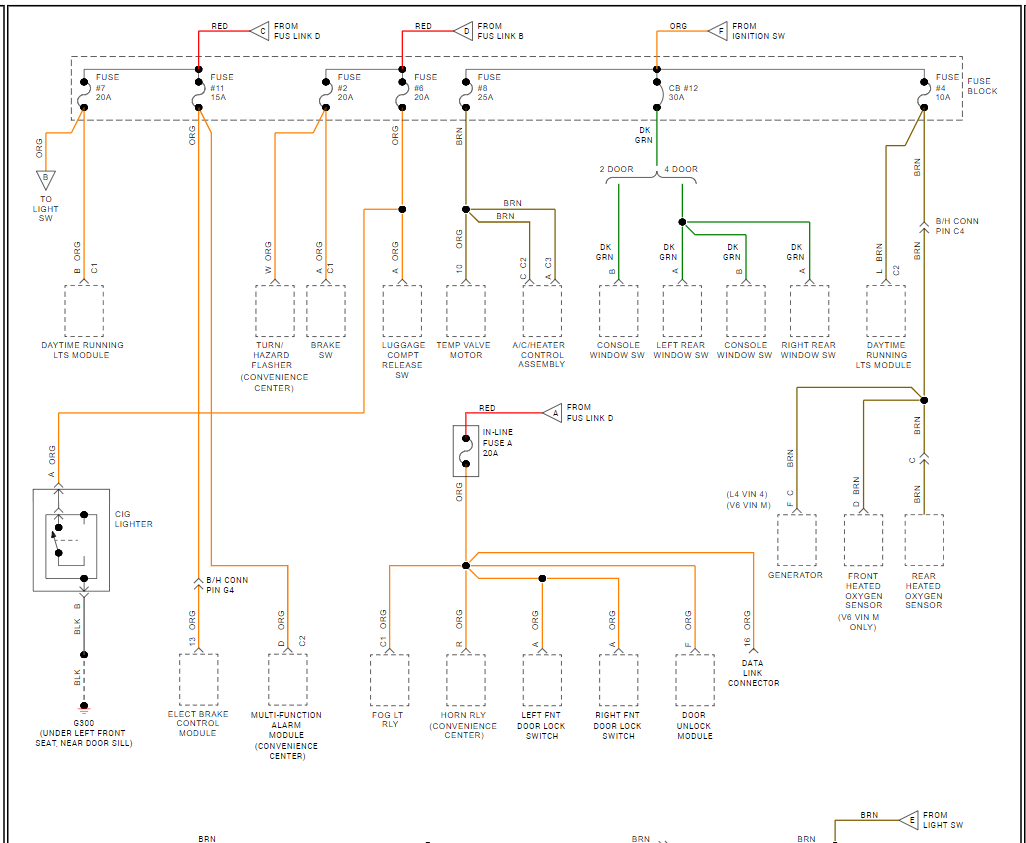

Ruby! Great name for a car BTW :) Here are the complete wiring diagrams for the power distribution and the fuse panels. It should give you all the information you need but if not please upload an image of anything you need help with to get Ruby going again. Check out the images (below). Let us know how it goes.

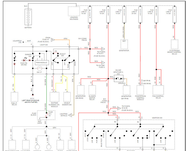

Is there a male blade terminal pinout cheat sheet ? Color coded wire guide maybe for the C100 engine bay/cabin firewall fuseblock connector junction box. For Aptiv Delphi mixed series F my car Ruby? Thank you

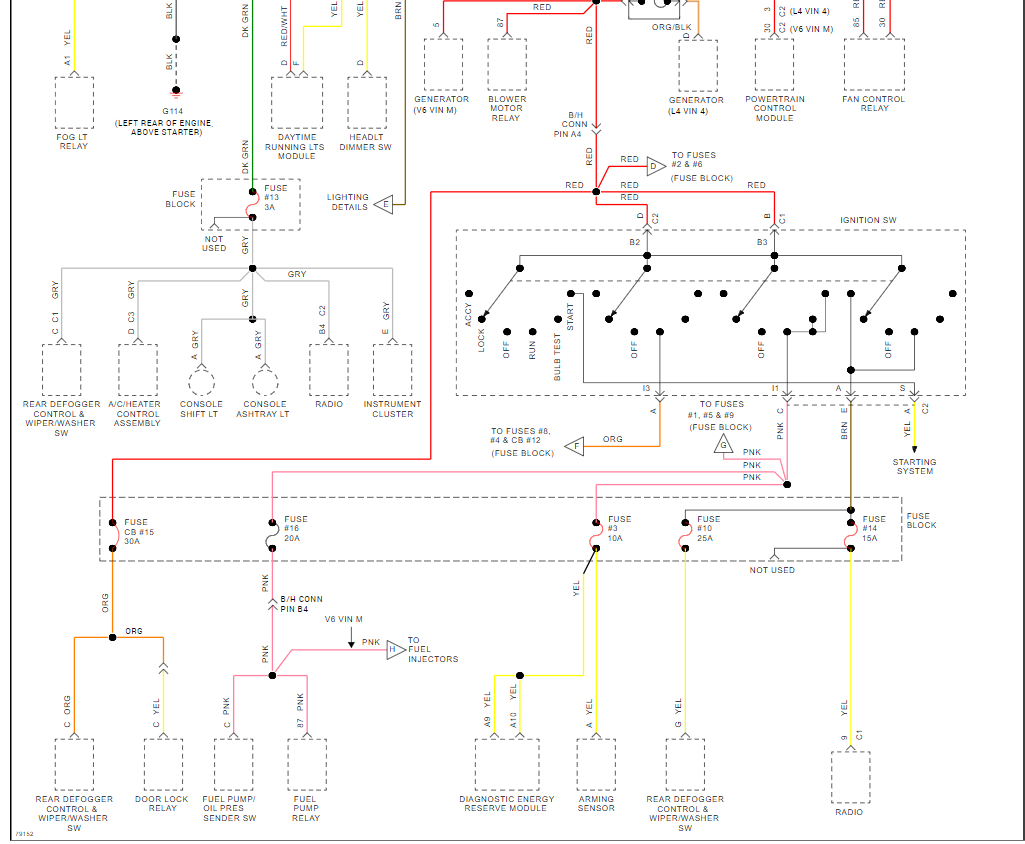

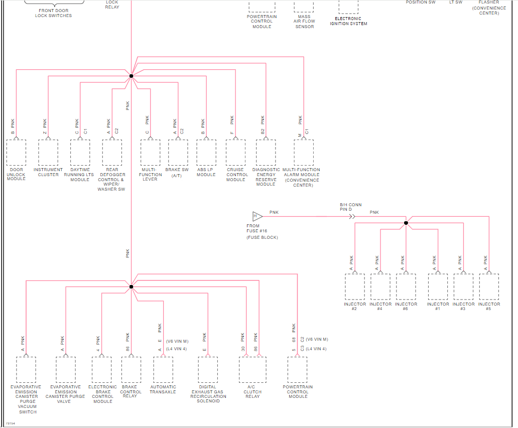

Hello Ken! Well, it's been a while. The diagrams you sent me are greatly appreciated but I noticed the diagram has 6 sparkplugs and Ruby is only a 4: banger!? So, a little confusion. I'm new to all of this. I can change parts all day but as far as true mechanic work ....? I have bought GM manual platform F. 3 books !! Anyway I've been studying since our last talk and I'm about to wire her bulkhead back together , put on a H20 pump, radiator fan, HVAC blower , brake line and fire ol Ruby up for the 1st time in a year and a half. If there is any advice anyone can give me concerning bulkhead pinout for 96 Chevy Corsica 2.2l automatic fwd please let me know! I'm all ears. And thank you to Ken and all the help from 2carpros. There guidance has been invaluable. Thank you, Trent Beasley

Correction! My bad, you didn't send me a diagram with 6 plugs for Ruby. I was looking at the fusible links!!! U sent me the right information for Ruby ! My 4 banger Corsica 2.2 l auto . Just wanted to apologize. Told you I was a newbie.
