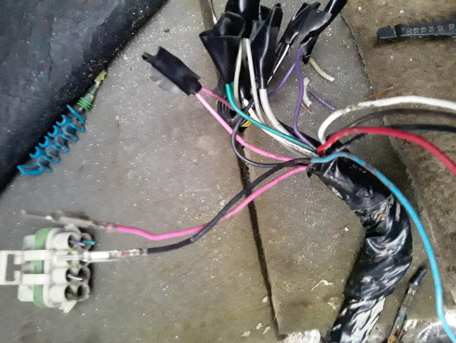

Okay, let us back up.
Match up the ones that match. Take a picture of the remaining ones and let me know. I need to see both the harness inside and outside as well. Tape the wires together, for now, to see what does not match.

The pink and black ones have no wire to connect to on other connectors.
Wednesday, February 12th, 2020 AT 2:17 PM
KIPP_1992
  • 18 POSTS
All other wires match up with another except those two.
Wednesday, February 12th, 2020 AT 2:21 PM
  • 52,797 POSTS
Good.
Those 2 are for the solenoid I told you about. They go to the vent solenoid.
There should be a 2 wire connector to attach those wires.
Wednesday, February 12th, 2020 AT 2:26 PM
KIPP_1992
  • 18 POSTS
There's only the connector that had 8 wires the connector that had 4 and a connector with one single wire that is light blue. There is no 2 wire connector.
Wednesday, February 12th, 2020 AT 2:30 PM
  • 52,797 POSTS
Okay, go to the solenoid. I posted the picture back a few posts. Those wires need to be run to that solenoid.
Wednesday, February 12th, 2020 AT 2:36 PM
KIPP_1992
  • 18 POSTS
There's no wires going from solenoid to where that connector is located and no that I took the connectors off. I have TCS light on and ABS light.
Wednesday, February 12th, 2020 AT 2:45 PM
  • 52,797 POSTS
If you have an ohmmeter, ohm the wires from the solenoid to the loose wires and see if you have continuity.
