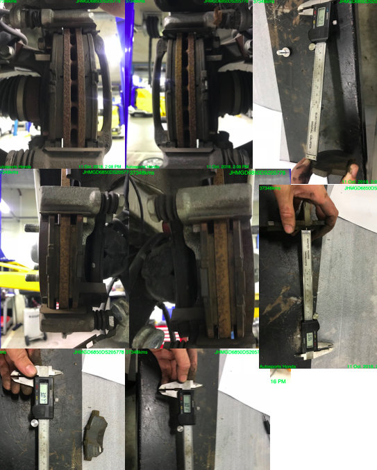

I need another option please. Do I get them to change the pads?
I am about to purchase this car and my mechanic who did the third party check on the car has recommended that the front brake pads get replaced including the discs before purchasing. He says these will need changing before 5,000 kms
My mechanic has recommended the following.
FRONT BRAKE PADS
FBD FRONT BRAKE DISC ROTORS
BF BRAKE FLUID
Removed old brake fluid and replaced with new brake fluid. Pressure or vacuum bled each caliper and/or wheel cylinders by opening each bleed nipple one at a time until new brake fluid with no air bubbles is visible
LAB LABOR
Discs below minimum specifications. Removed pads,
caliper carrier and discs. Cleaned hubs and new disc rotors. Refit caliper carrier. Lubricated new brake pads and refit new brake pads. Test drove to bed brake pads to discs
the dealership has come back and said the pads do not need changing and have attached the following photos.
What do you think?
I am about to pay $12,000 for this car with only three months warranty. I am trading in a car (lemon) I brought from these guys a year ago for $8,900.00 which they are trading for $6,500.00. This previous car has been a nightmare since purchasing from oil leak to new battery to now what I think has always been the care, I suspect a gear box issue.
Anyway, lets say I do not trust them but they have said they will change the brakes if I can prove they need doing. Hence why I am asking you?
If you cannot see the image, the readings of the brakes I believe are.
1. 4.27
2. 4.69
3. 3.01
4. 3.07
Thank you so much for your time and thoughts.

See attached for images. Thanks so much for sharing your thoughts an expert opinion.

Thanks for the pictures.
The pads are under 50% but the key is the failed rotors. They need to replace the rotors and pads together. For 12,000 for the car, they can afford $30.00 for pads. They have to remove them anyway to replace the rotors.

Thank you so much Roy for your advise. How can I prove that the pads are under 50%?
I tried to find specifications online. Also why should they to be changed is under 50%? The head at this Honda dealer put in CAPS on the report. These do not need changing. Again any reference points for me would be greatly appreciated. Also fab to know they are cheap, although obviously they make it sound like its above and beyond the deal we are making.
Just keen to get a little more information to give them tomorrow when I continue negotiations.
Many Thanks, Candice
Thursday, October 11th, 2018 AT 3:37 AM
It should have been documented on your report in 32. Anything below 6/32 is below 50%. 12/32 is new. Any professional shop will not use old pads on new rotors. If they do, it is not a place you want to do business.

I am based in Sydney. The reading I can see if 3.01 what does this mean in context of what you mentioned above.
Candice
Thursday, October 11th, 2018 AT 3:46 AM
No, that reading does not make sense at all.
Ask the dealer what reading they have for the pads.

Okay, so your feedback on the less than 50% was based on looking just at the images not the readings?
Thursday, October 11th, 2018 AT 3:53 AM
Correct but it needs to be confirmed.
It does not matter what percentage it is. You replace pads with rotors, period.

Thank you. I think their point is more that nothing needs replacing. They think there is up to 10,000 kms left on these. My mechanic says it is less than 5,000 kms and they need to all be done as part of the purchase. Do you agree? As you able to make a statement I can take with me as an additional opinion? That would be great. Thank you again.
Thursday, October 11th, 2018 AT 4:07 AM
No, I cannot make a statement. I am here and not there and am going on nothing that is specific.
I would need to inspect it myself to make an accurate statement.

To me, it appears that those pads have plenty of life left in them. It is a little hard to tell from a picture, but I would say they still have half of their lives left. Your mechanic is probably either (1) playing it safe or more likely (2) trying to drum up some business.
As for the rotors, there is no way to tell for sure from a picture, as precise measurements are needed. However, I would say that with only 37,000 miles on it, the rotors are probably fine. I have seen cars with 200,000 miles on them with the original rotors still on there.
Basically, I think that the mechanic shop is trying to take you for a ride.
Thursday, October 11th, 2018 AT 6:34 PM (Merged)
HARRY P
  • 2,296 POSTS
Sorry, I just saw the rotor measurements. I stand by my earlier statement though.

Candice, as per our lengthy conversation this morning, my suggestions have not changed.
My fellow technician agrees with me about this. There is not more suggestions from our end. They need to be done, period.

You need to push for them to repair this before you take delivery. It is a deal breaker in my opinion.
CANDICEQUARTERMAIN
  • 9 POSTS
Thanks Roy, they have agreed to change the pads and machine the discs. Appreciate your help.
