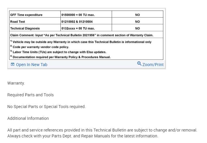

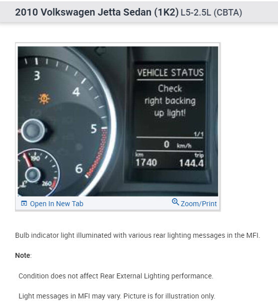

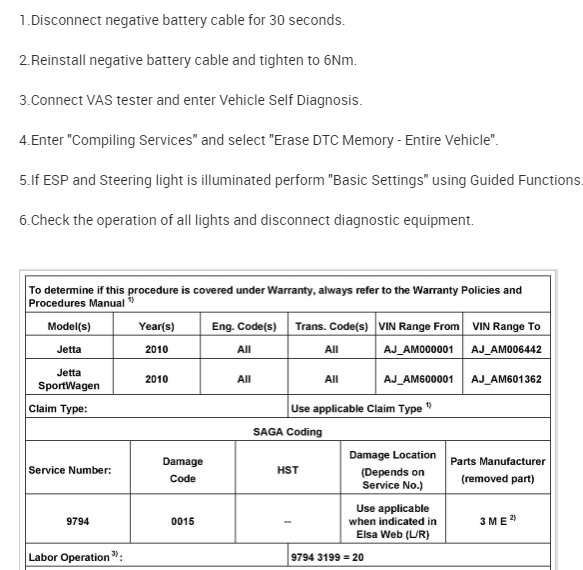

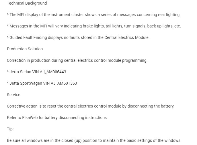

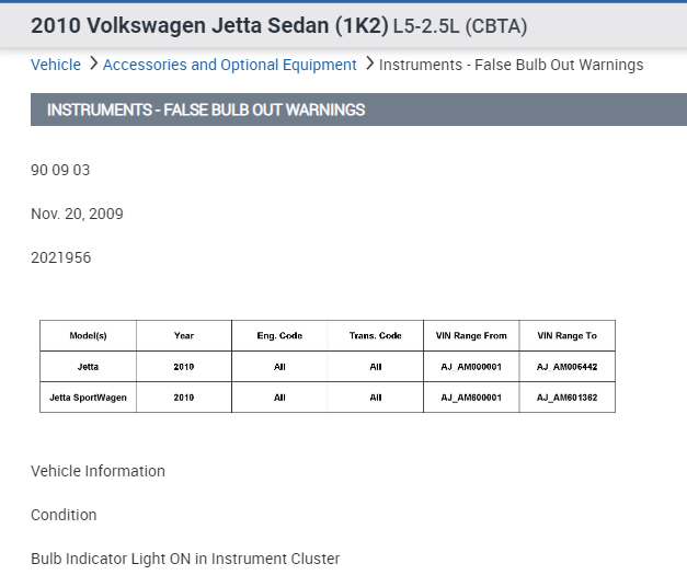

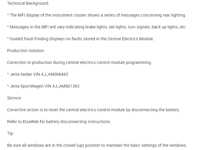

The circuit is designed to recognize low or no voltage at any of the bulbs. Does it indicate a specific light? By any chance, has anyone changed any of the bulbs to LEDs? That will cause this. I did find a technical service bulletin (TSB) related to an issue. I will attach that below in the pics.

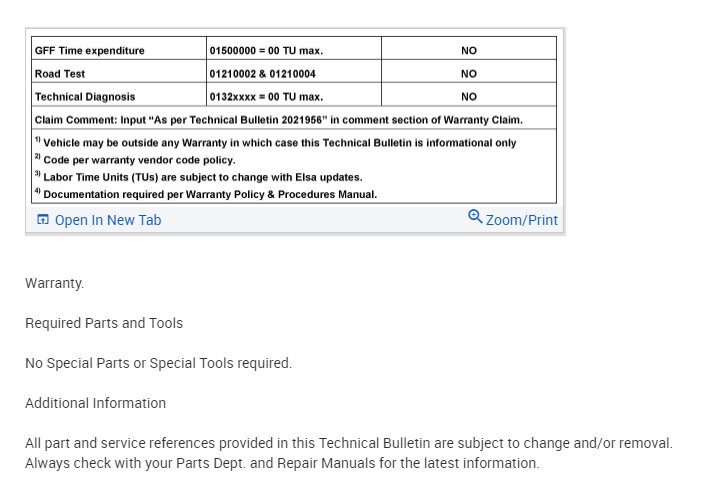

If that doesn't help, take a look through this TSB and let me know if you feel it is relevant to your issue.
See pics below. The TSB is somewhat technical, but I wanted to make you aware of it.

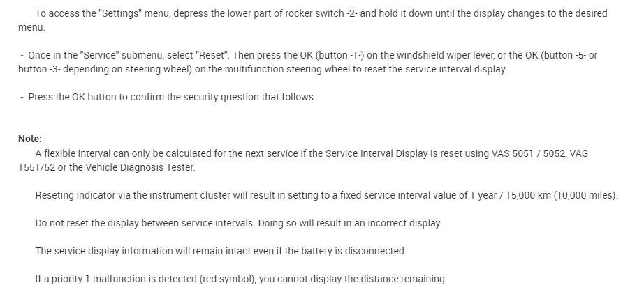

The low beams have been changed to LED lights by Lasfit. I went and got inline resistors. Light remained. I went and bought 4 h7 night vision halogens. Still had the light on. So, I put the LEDs back in. I'm going to go out and try that reset procedure. By the way do you know the reset procedure for the service message with the wrench?
Thursday, February 9th, 2023 AT 6:48 PM
  • 110,192 POSTS

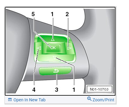

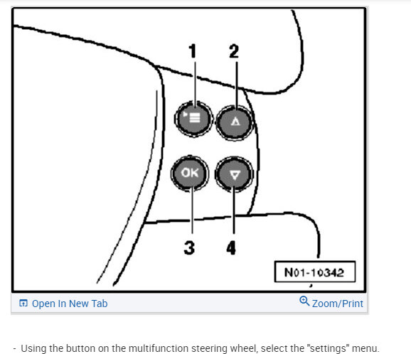

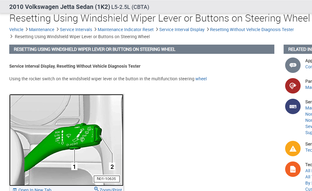

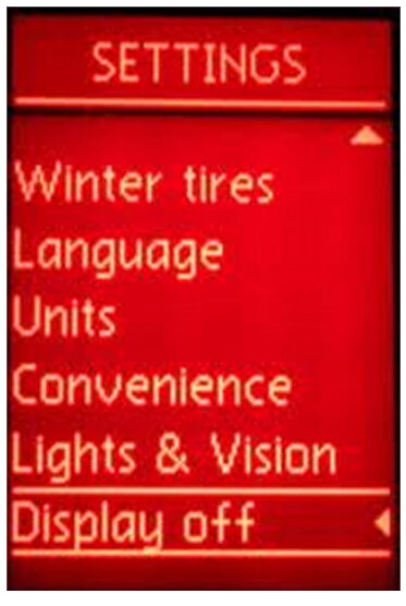

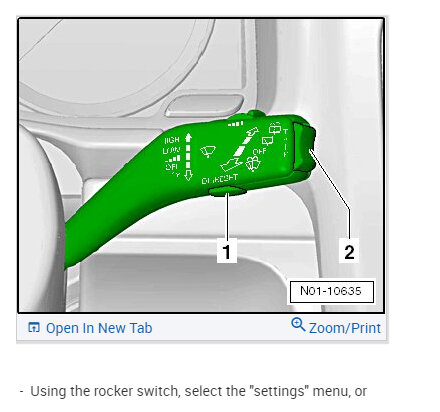

I attached the directions below. There are three different set-ups based on the vehicle. Basically, the buttons used may look different or be in a different place. All are included.
Let me know if this helps.
Thursday, February 9th, 2023 AT 7:05 PM

Okay, I've tried this multiple times and can't get anywhere. As far as the TPS goes it sounds kind of like the issue I'm having, however the VIN number range doesn't include mine.

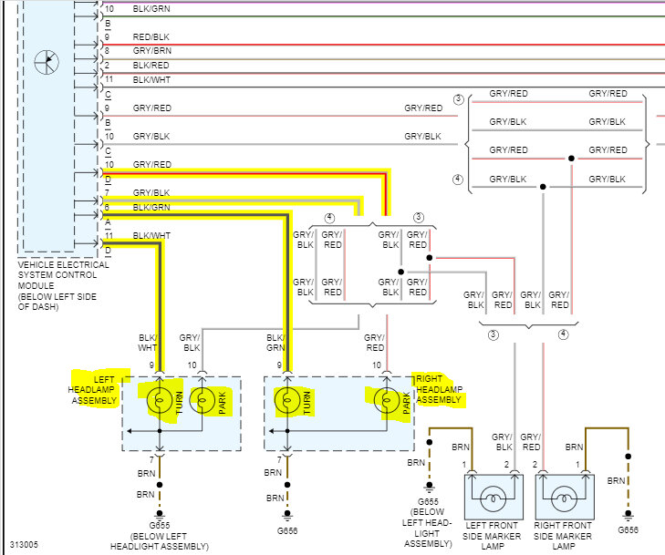

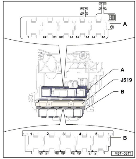

I don't have the extra features in the info screen. No adjustment features on the windshield wiper arm, and no adjustments on the steering wheel either. I went from light to light today with a multimeter. All the bulbs are good. However, the orange turn signal bulbs in the headlamp housing are the wrong ones, as well as the small bulbs that are in with the high beams. They both have the wrong bulb number. It has #194 bulbs and is supposed to be the w5w. Funny thing is the Wires seem to have something wrong. Both sides will not go to zero. Down to around 3 to 3.5. All the other lines went to around.8.
What could be causing this?
Saturday, February 11th, 2023 AT 1:47 PM
  • 110,192 POSTS
Were you able to get the correct bulbs? If so, did it make any difference?
As far as the 3v to 3.5v, that is usually the result of a short to power, in this case, it is minimal. However, you are correct. It shouldn't be present if things are turned off.
What to do is locate the vehicle electrical control module. It's under the dash on the left. See pic 2 below.
Pic 1 shows the wires to the module from the headlamp assemblies. You need to see if there is power present all the time there or if there is a connector issue. Pic 1 shows the module wiring.
Let me know what you find.

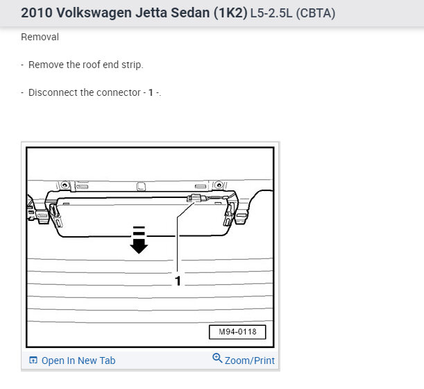

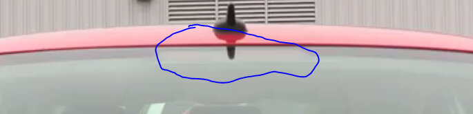

Okay, sorry, it has taken so long to reply. Life became a little hectic. Anyways picked up a AutoPhix 7610 code reader. Left low beam, right low beam, and high mount brake light. I don't see a high Mount brake light. Can I shut that off and did that car even come with a high mount brake light? The only other code is for the radio because it is not the factory radio it is a Sony so that leads me to my question about adaptation. Is there any way I can like adapt that one in there in place of the factory one?
Friday, February 24th, 2023 AT 6:55 PM
  • 110,192 POSTS
As far as the radio is concerned, to the best of my knowledge, no. It can't perform the same way as the OEM radio.

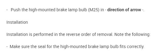

As for the high-mount brake lamp, it should be at the top of the rear window. See pic 1. Pics 2 and 3 are directions for its removal.
Let me know if it's there.
