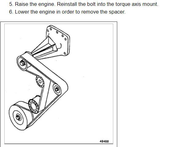

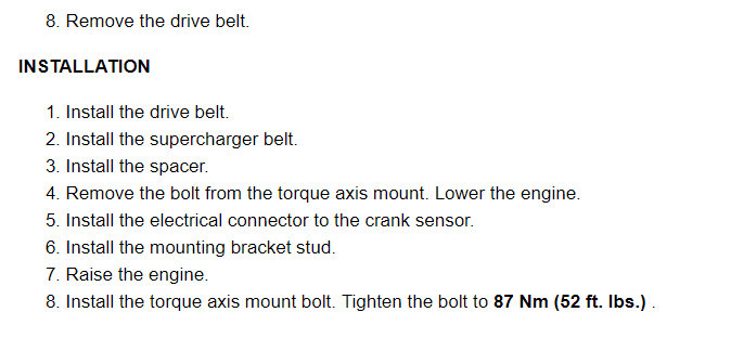

Here's the procedure for removing the belts and a link. Installation is the reverse of removal.
https://www.2carpros.com/diagrams/buick/riviera/1997
NOTE: This engine uses two accessory drive belts. The outer belt drives the supercharger. The inner belt drives the generator, power steering pump, coolant pump and air conditioning compressor. All driven accessories are rigidly mounted to the engine. Drive belt tension is maintained by the spring loaded belt tensioners. Each belt has its own tensioner.
GENERAL INFORMATION
A belt squeak when the engine is started or stopped is normal and has no effect on belt durability. The drive belt tensioner can control belt tension over a broad range of belt lengths due to stretching; however, there are limits to the tensioners ability to compensate. Using the tensioner outside of its operating range can result in poor tension control and/or damage to the tensioner. The belt should be replaced when this condition occurs.
REMOVAL

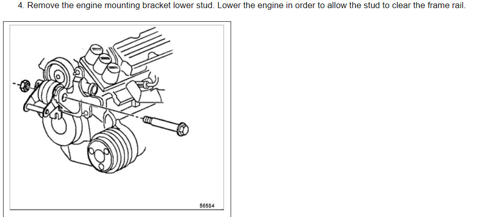

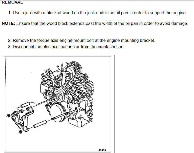

1. Use a jack with a block of wood on the jack under the oil pan in order to support the engine. NOTE: Ensure that the wood block extends past the width of the oil pan in order to avoid damage.
2. Remove the torque axis engine mount bolt at the engine mounting bracket.
3. Disconnect the electrical connector from the crank sensor.
4. Remove the engine mounting bracket lower stud. Lower the engine in order to allow the stud to clear the frame rail.
5. Raise the engine. Reinstall the bolt into the torque axis mount.
6. Lower the engine in order to remove the spacer.

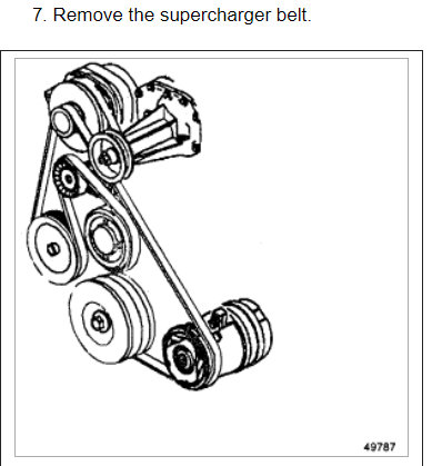

7. Remove the supercharger belt.
8. Remove the drive belt.

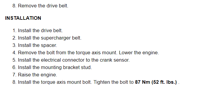

Here are diagrams and instructions form the book so you can see how they do it.

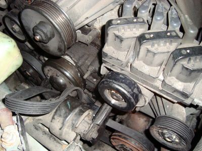

6 cyl Front Wheel Drive Automatic 175000 miles How do you install serpentine belt for 1997 Buick Riviera.
https://images.2carpros.com/forum/automotive_pictures/448082_DSC00758_1.jpg

Here is a sure-fire procedure for replacing the serpentine belt on a 97 Buick Riviera (I think this may work on all 96-99 Rivieras):
Place a floor jack under the oil pan. Protect the oil pan by using a 2x4 long enough to span the whole pan. You are going to lower the engine about two inches. This is necessary to remove a bolt and sleeve which is blocking your ability to remove the belt and install a new one. Once the motor is supported snugly with the floor jack remove the lower motor mount bolt holding the front end of the motor. It is easily accessible on the passenger side of the engine. You may have to fuss with the jack to keep from pinching the motor mount bolt but it WILL come out. Locate a star shaped bolt located near the harmonic balancer and crank sensor plug. It may be necessary to first remove the 18 mm nut or use a 8mm on the star shape bolt to remove the bolt from a sleeve. You will have to lower the engine using the jack about two inches to get enough clearance to completely remove this bolt. The sleeve can then be removed with a bit of effort. Loosen the belt tension by torquing the tensioner pulley counterclockwise using a 15 mm socket and a breaker bar. Pull the belt off of the alternator pulley and you can then remove the belt completely.
Snake the new belt below the place where the sleeve was and under the bottom pulleys. Replace the sleeve and the star shaped bolt. Jack up the engine and replace the motor mount bolt. Again, jockeying the jack will help mate up the bolt to the hole. It should slide back in without much effort but some oil might help. You should be able to find a diagram of the belt online. Once you have it in place again torque the tensioner pulley counterclockwise and slide the belt onto the alternator. Check to make sure it is squarely centered on all the pulleys and you are good to go. Hope this helps!!
