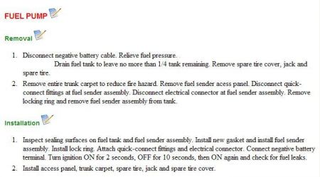

How do you drop the fuel tank on a supercharged 95 buick riviera to replace the pump?
Tuesday, April 7th, 2009 AT 4:02 PM
BLUELIGHTNIN6
MECHANIC
16,542 POSTS
Fuel tank does not need to be dropped. Replacement procedures are below for your vehicle's fuel pump..
