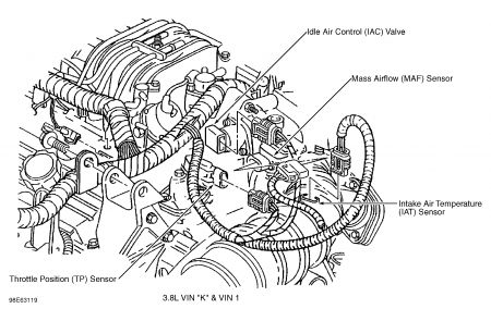

Where is the Mass Air Flow Sensor located, I want to check any connect problem.

Depends on engine size if 3.1 it's in the air cleaner duct on left side of engine. If it's a 3.8 it's part of the throttle body. Shown is the 3.8.
