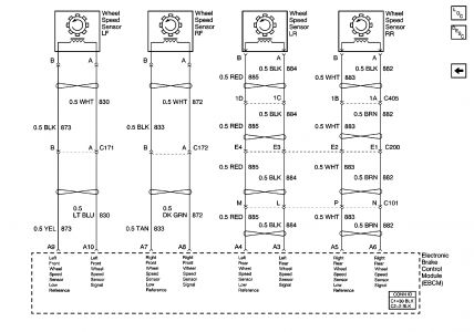

DENNYP
  • 1,824 POSTS
https://images.2carpros.com/forum/automotive_pictures/102900_speed_sensors_1.jpg

RE: The last page with the diagrams on it -- the printing is so small I can not really read much of it and especially when I go to print it out on my printer, you can't read any of it!! Is there any way to make it bigger before you post it?? And what are the thingies connecting the right & left set of lines for each of the 4 sets??

DENNYP
  • 1,824 POSTS
Save the picture and open it with paint or windows picture and fax viewer. The loop looking things are to show the wires are twisted together. All of the b terminal wires are reference and a terminals are signal wires.
