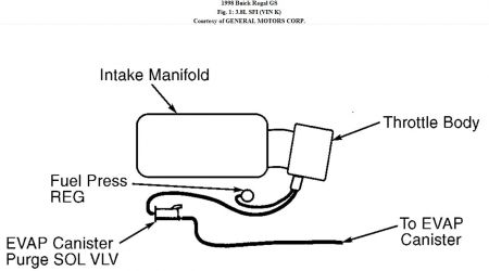

I know it is a evap leak I just need vaccum diagram so I can trace the hoses.
Sunday, June 6th, 2010 AT 9:58 AM
MERLIN2021
MECHANIC
17,250 POSTS
Check the gas cap as a first step! This is all I could find, but the same diagram is under the hood, or should be!
