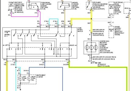

My brake lights do not go on except the one in the window. I was tolk that I need a new signal switch in the sterring collum

You were told correctly. The stoplights receive their signal from the brake switch via the multi-function switch.
