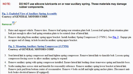

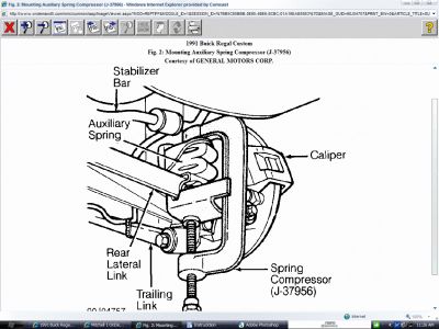

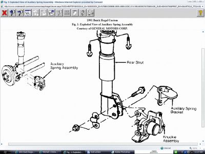

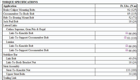

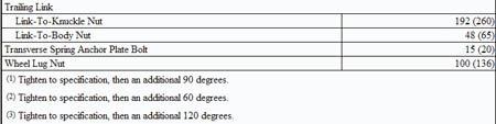

Removal and installing rear leaf spring

Here's the info...
