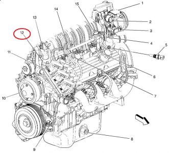

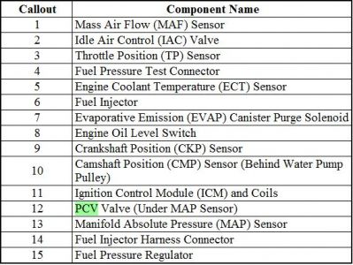

where is the PCV Valve located at on the engine?
Monday, April 13th, 2009 AT 4:34 AM
