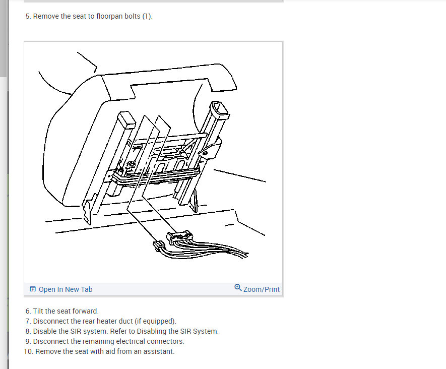

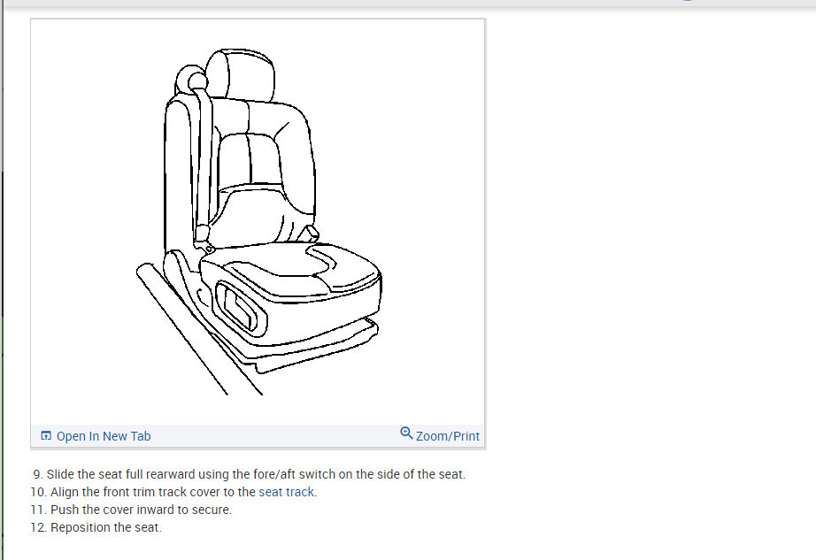

how do i remove the front power seats.
Jul 20, 2009 at 3:52 PM
  • CAR REPAIR CONTRIBUTOR

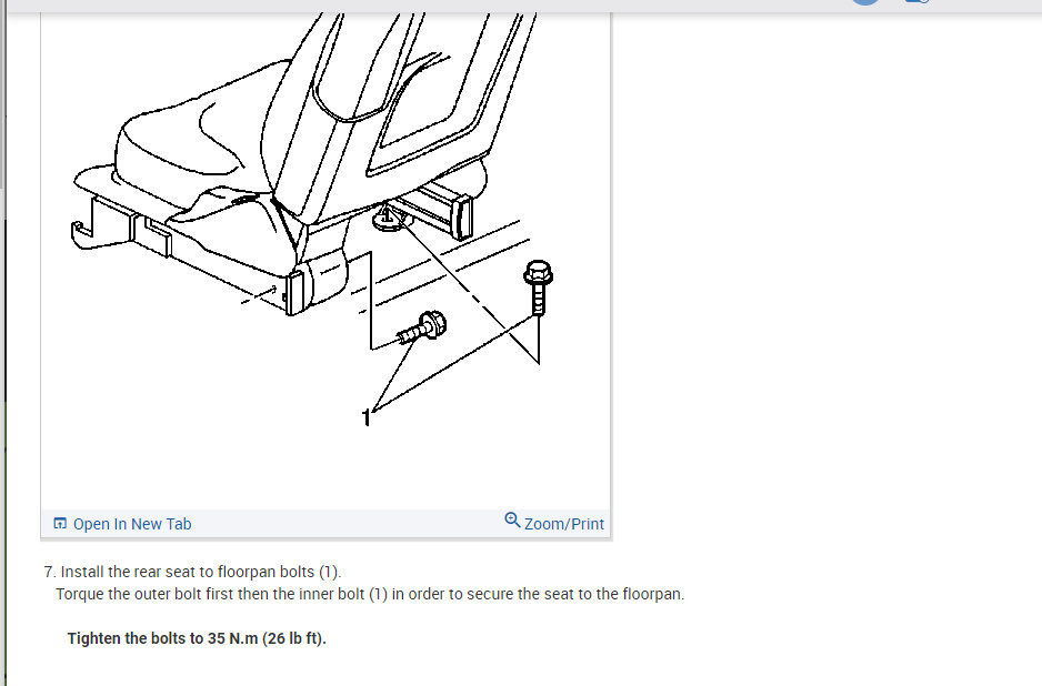

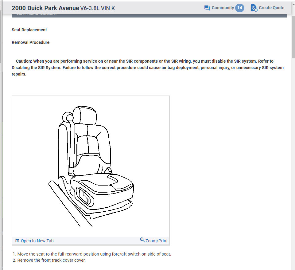

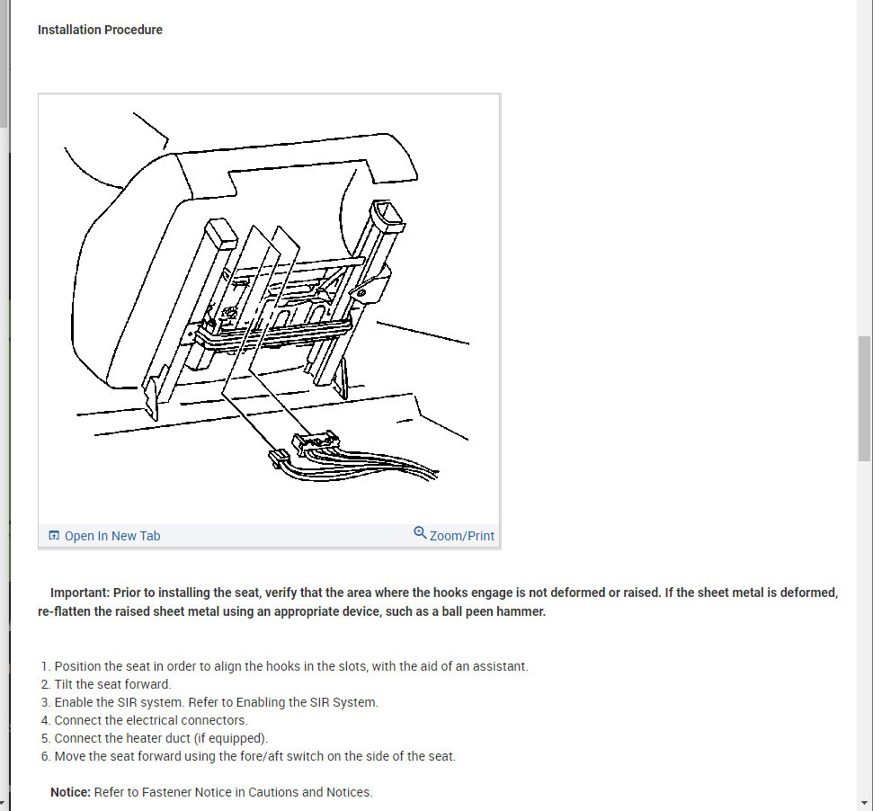

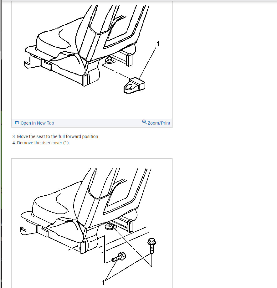

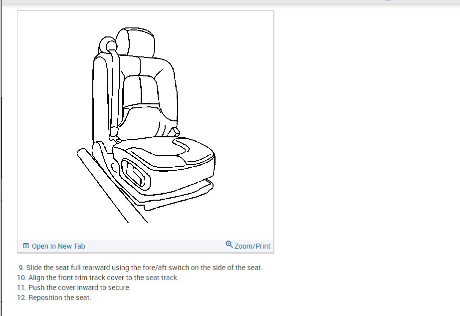

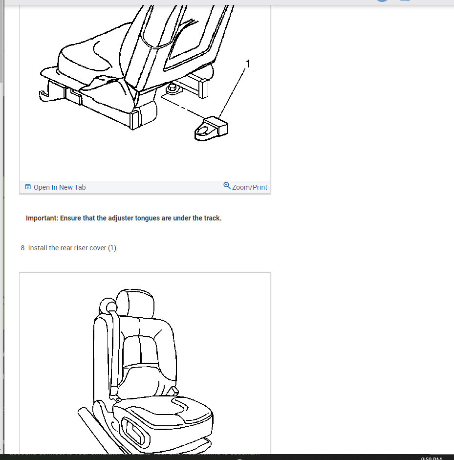

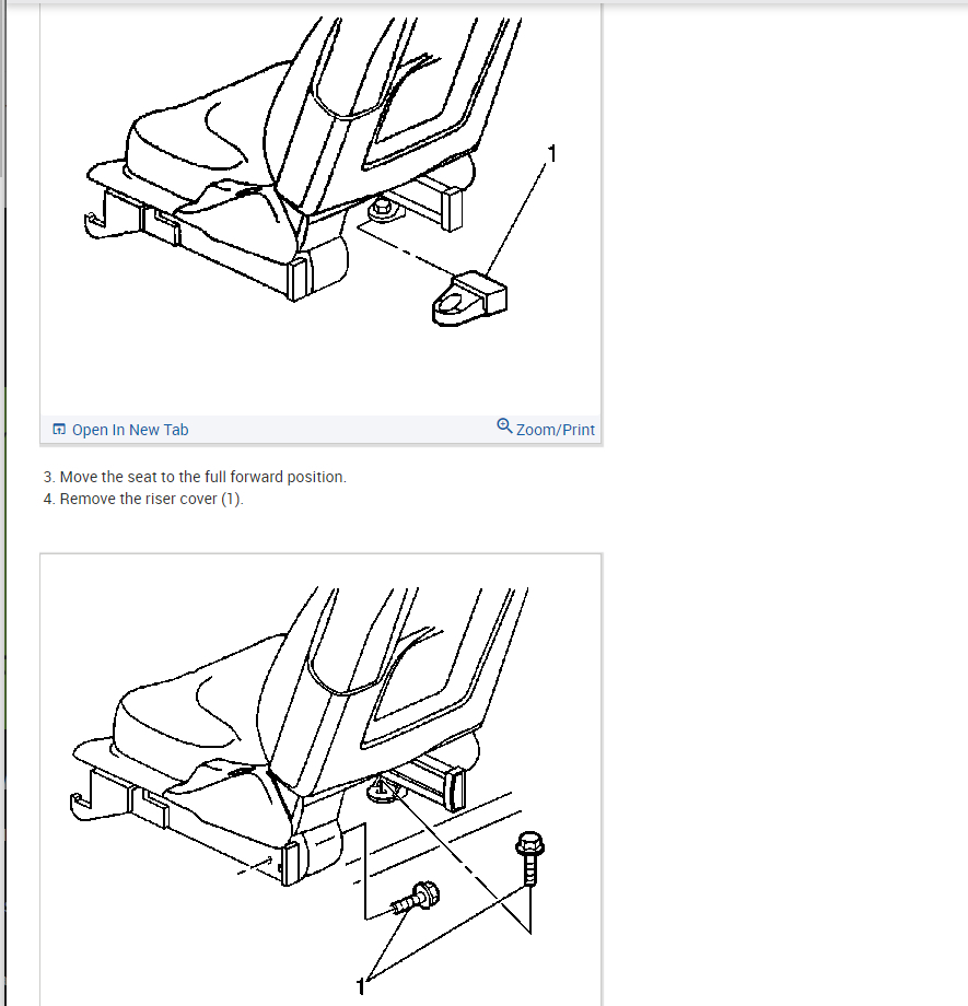

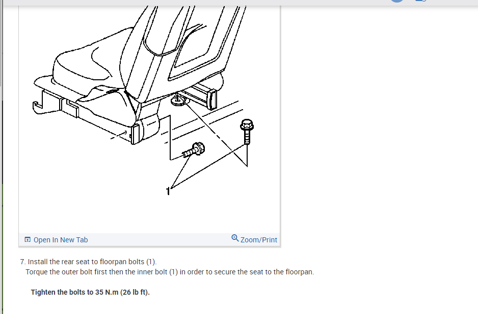

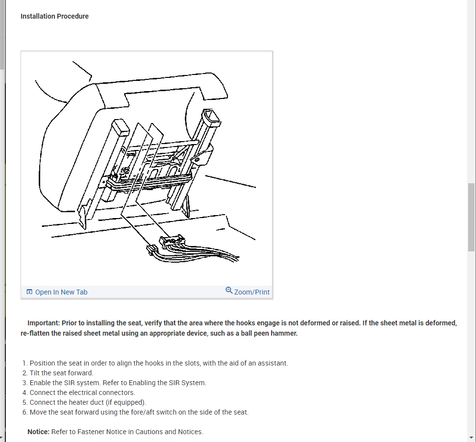

Basically you need to remove the bolts on the rear of the seat frame and you can remove it.
I am attaching the info below from the manual on how to remove this seat.
Please run through this info and let us know if you have other questions. Thanks
