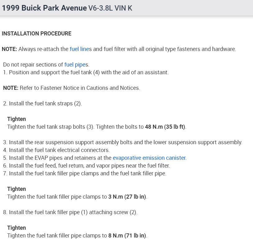

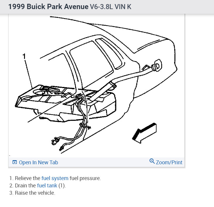

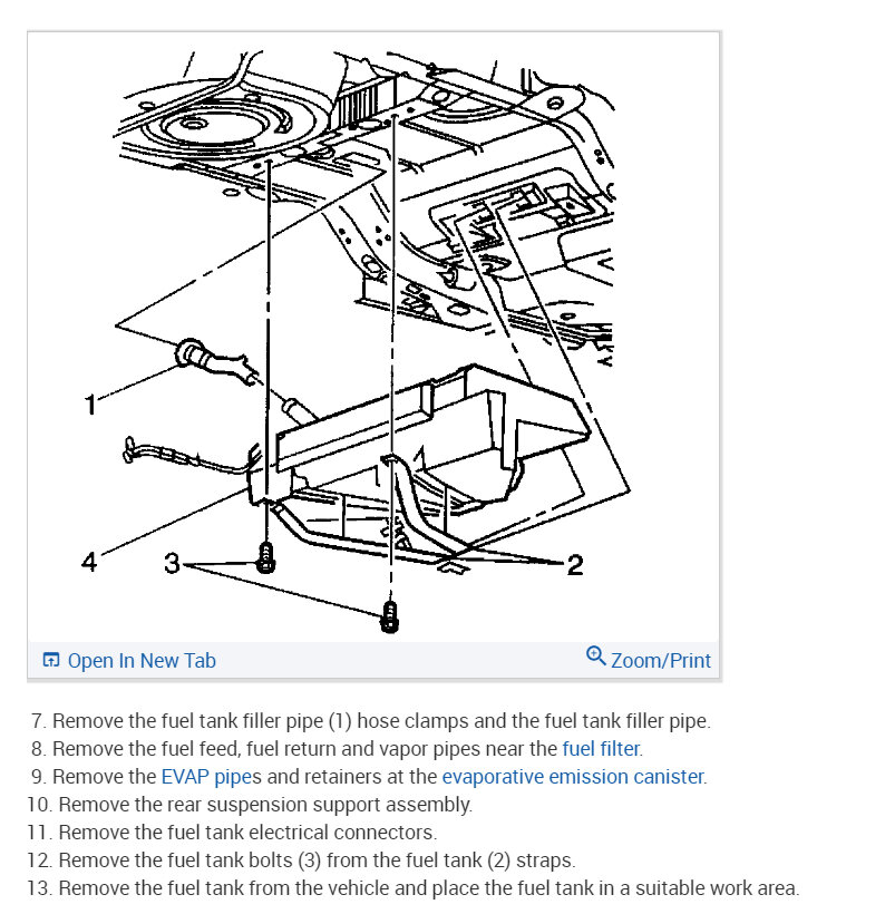

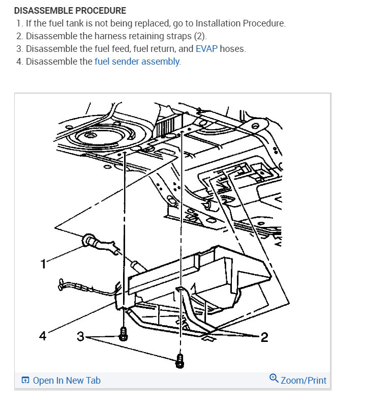

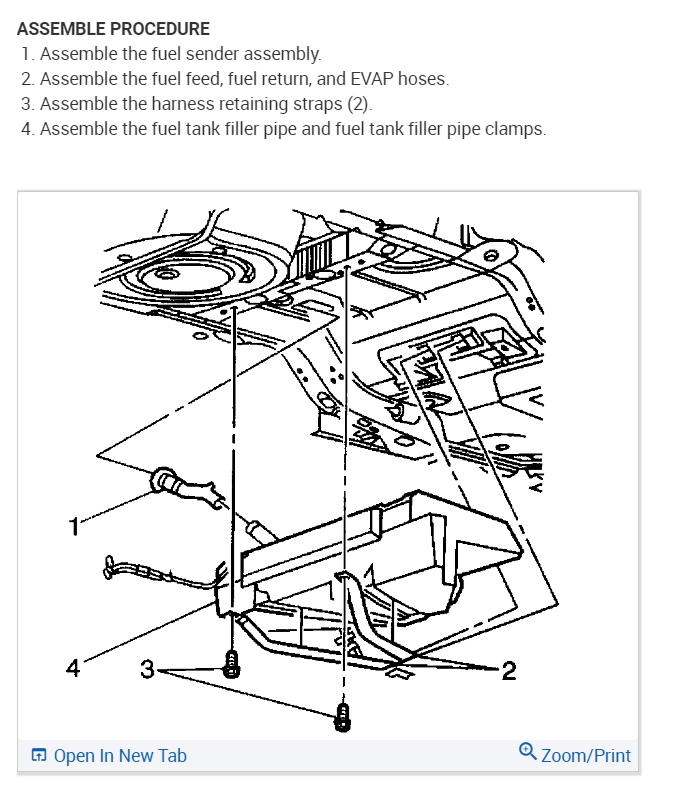

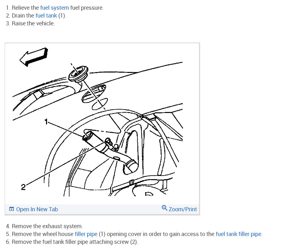

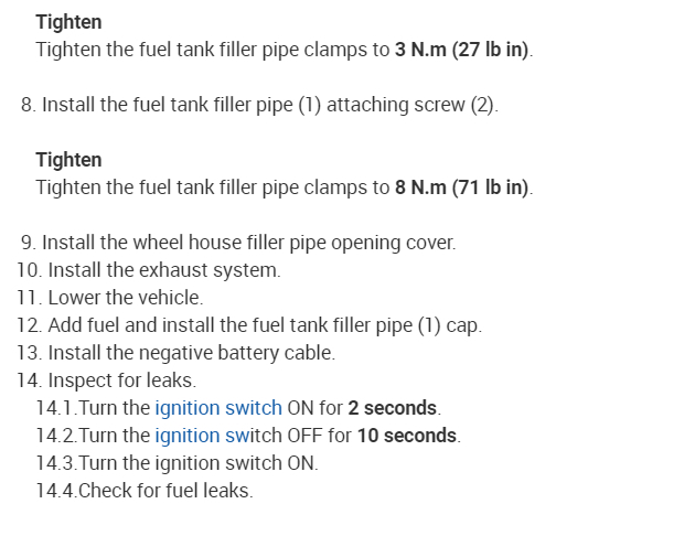

The pointer on my gas gage is below the pin on the empty side of the gauge. How do I repair this or get the pointer back into operation?
Friday, December 5th, 2008 AT 5:31 PM
DOCFIXIT
  • 18,828 POSTS

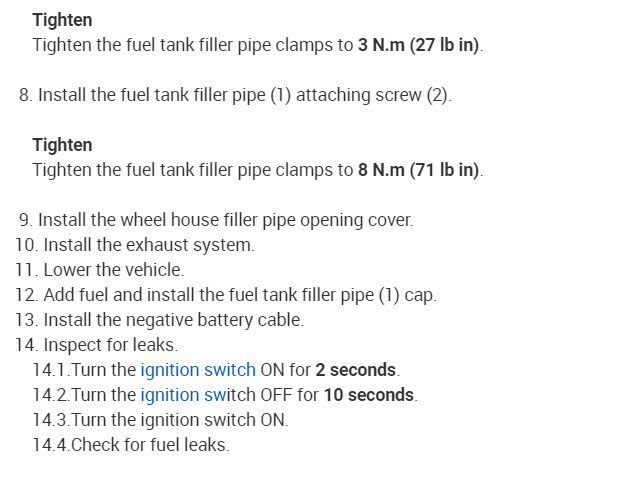

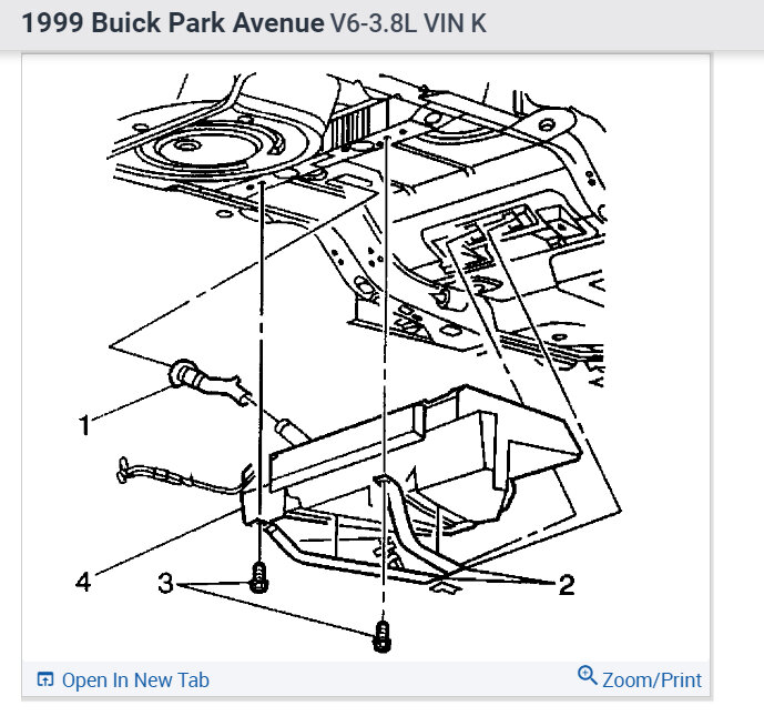

The fault is most likely the sender in the fuel tank. Here is the instructions on how to change the sender out. Check out the images (Below). Please let us know what happens.
