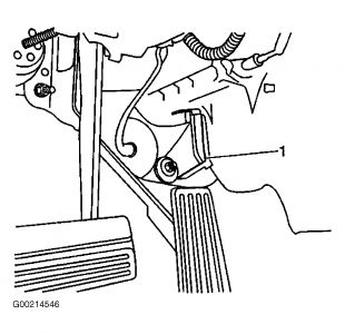

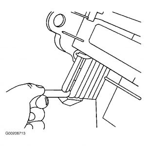

I need to open the actuator door in front of the cabin air filter, how do I access the cabin air filter under the dashboard?
Wednesday, October 13th, 2010 AT 2:50 PM
DOCFIXIT
MECHANIC
18,828 POSTS
Remove insulation panel then push down and pull out access cover
then remove tape on filter then pull tab and filter out
