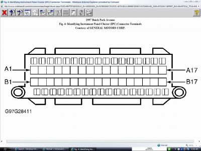

1997 Buick Park Avenue Wheel Drive Type unknown Automatic 174000 miles
The temperture and fuel gauges no longer work. The needles for both gauges are pegged on the back side of the little post on each instrument face. The sensors for the fuel and temperature seem to be working as the low fuel indicator light still comes on when the tank gets low and the tempurature does show up when I scroll through the instrument readouts on the dash. Can the analog instruments be fixed?

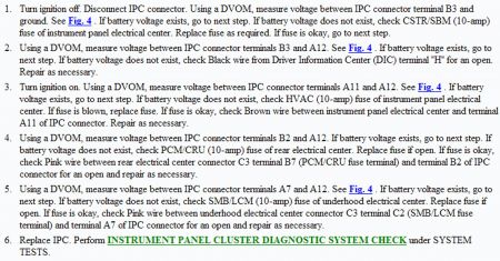

Heres the tests you need to run...happy hunting!
Check cluster fuse first!
