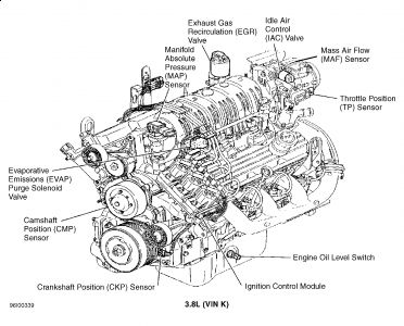

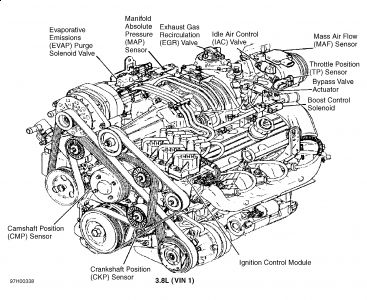

Where exactly is it
Saturday, August 15th, 2009 AT 3:44 PM
DOCFIXIT
MECHANIC
18,828 POSTS
Here is pics of the two possible engines for your car
