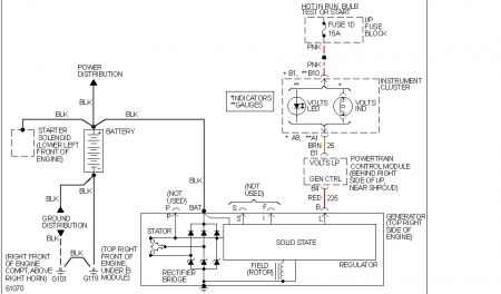

i need a diagram to rewire my altonater

What exactly are you trying to do?

I found this diagram, below. I didn't see your post, wrenchtech, have a good day.
