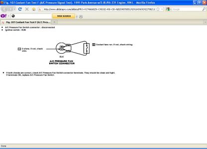

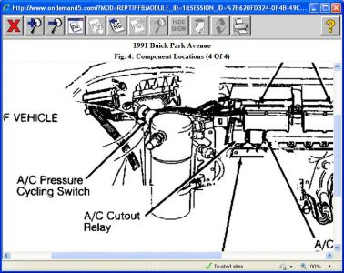

https://www.2carpros.com/forum/automotive_pictures/416332_1991_buick_park_ave_high_low_switch_1.jpg
If your a/c work's turn it on does your fan come on?If your a/c doesn't work then locate your a/c high low switch turn on your a/c and unplug the high low switch jump across the two terminals the a/c should kick on and so should the fan did it?Let me know this will test the wiring relay fuse's fan motor make it a lot easier to figure out.I posted a diagram of where the switch is.

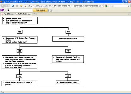

https://www.2carpros.com/forum/automotive_pictures/416332_1991_buick_park_ave_testing_the_coolant_temp_sensor__1.jpg
https://www.2carpros.com/forum/automotive_pictures/416332_1991_buick_park_ave_testing_the_coolant_temp_sensor_part2__1.jpg
Lets do this i posted where your coolant temp sensor is there should be a yellow wire and a black wire going to it.I also posted a resistance chart for the sensor see if the resistance value matches with the actual coolant temp.Use a ohm's meter also while it's running jump the coolant temp sensor connector terminals together and see if the radiator fan come's on.Let me know what you find.

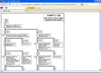

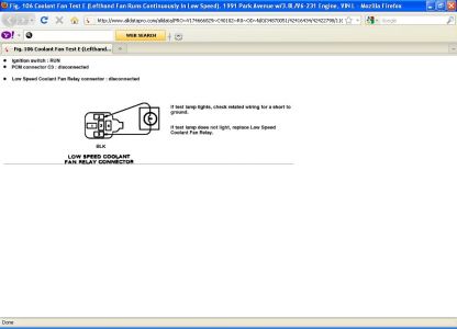

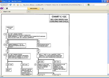

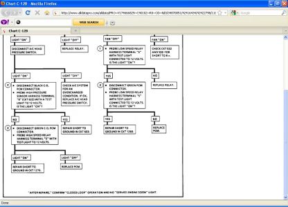

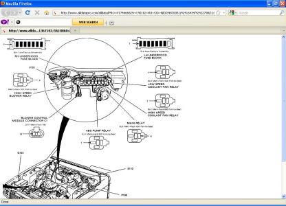

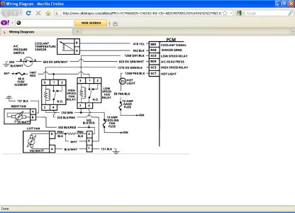

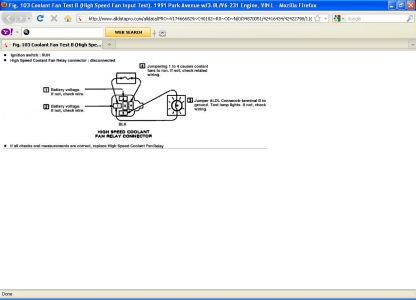

https://www.2carpros.com/forum/automotive_pictures/416332_1991_buick_park_ave_coolant_fan_relays_1.jpg

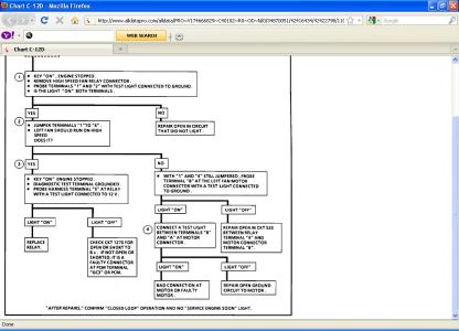

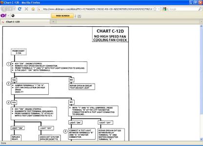

https://www.2carpros.com/forum/automotive_pictures/416332_1991_buick_park_ave_coolant_fan_inop_trouble_tree_part1__1.jpg
https://www.2carpros.com/forum/automotive_pictures/416332_1991_buick_park_ave_coolant_fan_inop_trouble_tree_part2__1.jpg
https://www.2carpros.com/forum/automotive_pictures/416332_1991_buick_park_ave_coolant_fan_inop_trouble_tree_part3__1.jpg
https://www.2carpros.com/forum/automotive_pictures/416332_1991_buick_park_ave_coolant_fan_inop_trouble_tree_part4__1.jpg
https://www.2carpros.com/forum/automotive_pictures/416332_1991_buick_park_ave_coolant_fan_inop_trouble_tree_part5__1.jpg
https://www.2carpros.com/forum/automotive_pictures/416332_1991_buick_park_ave_coolant_fan_inop_trouble_tree_part6__1.jpg
https://www.2carpros.com/forum/automotive_pictures/416332_1991_buick_park_ave_coolant_fan_inop_trouble_tree_part7__1.jpg
https://www.2carpros.com/forum/automotive_pictures/416332_1991_buick_park_ave_coolant_fan_inop_trouble_tree_part8__1.jpg
https://www.2carpros.com/forum/automotive_pictures/416332_1991_buick_park_ave_coolant_fan_inop_trouble_tree_part9_1.jpg
https://www.2carpros.com/forum/automotive_pictures/416332_1991_buick_park_ave_coolant_fan_inop_trouble_tree_part10_1.jpg
https://www.2carpros.com/forum/automotive_pictures/416332_1991_buick_park_ave_coolant_fan_inop_trouble_tree_part11_1.jpg
https://www.2carpros.com/forum/automotive_pictures/416332_1991_buick_park_ave_coolant_fan_inop_trouble_tree_part12_1.jpg
https://www.2carpros.com/forum/automotive_pictures/416332_1991_buick_park_ave_coolant_fan_inop_trouble_tree_part13_1.jpg
https://www.2carpros.com/forum/automotive_pictures/416332_1991_buick_park_ave_coolant_fan_inop_trouble_tree_part14_1.jpg
https://www.2carpros.com/forum/automotive_pictures/416332_1991_buick_park_ave_coolant_fan_inop_trouble_tree_part15_1.jpg
https://www.2carpros.com/forum/automotive_pictures/416332_1991_buick_park_ave_coolant_fan_inop_trouble_tree_part16_1.jpg
https://www.2carpros.com/forum/automotive_pictures/416332_1991_buick_park_ave_coolant_fan_inop_trouble_tree_part17_1.jpg
Alright now Lets do this i posted a trouble tree for you to follow.Let me know what you find.
Wednesday, August 4th, 2010 AT 2:21 PM

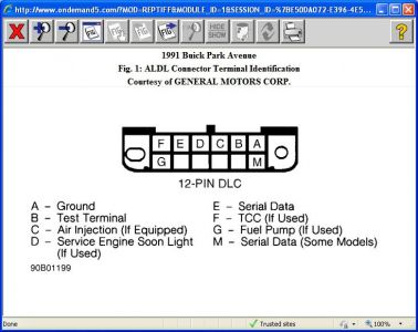

https://www.2carpros.com/forum/automotive_pictures/416332_1991_buick_park_ave_dlc_1.jpg
Sorry forgot to post this earlier it goes with the above trouble tree.
