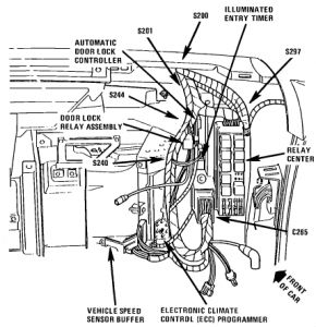

Loction of fues or relay for the fuel pump?
Saturday, May 22nd, 2010 AT 3:09 PM
MECHANIC
75,992 POSTS
Behind RH Side Of I/P.
The Fuel Pump Relay is located in the Relay Center. The Relay Center is located behind RH side of the Instrument Panel.
