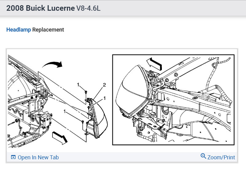

Good morning,

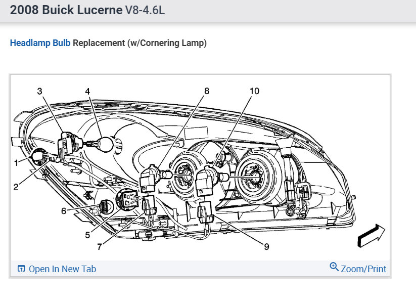

I attached the procedure and a picture for you of the replacement procedure for the headlight bulbs.
https://www.2carpros.com/articles/how-to-replace-a-headlight-bulb
Let us know if you have any other questions.

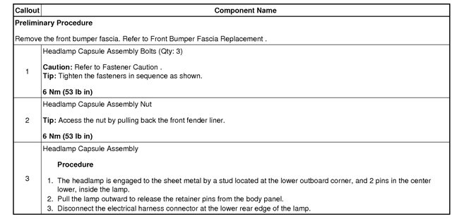

The owners manual does not show how to replace headlights bulbs. Another owner says it is a major repair issue in that you might have to remove the front bumper facia or more to reach the bulbs. Is this something the average car owner could do with a bit
of mechanical knowledge?
+2
Wednesday, November 25th, 2020 AT 8:31 AM (Merged)
GMTECH
  • 537 POSTS
According the manual, it says the front bumper/fascia needs to be removed to access the headlamp assembly. Here are the instructions in the diagrams below. Please let us know if you need anything else to get the problem fixed.

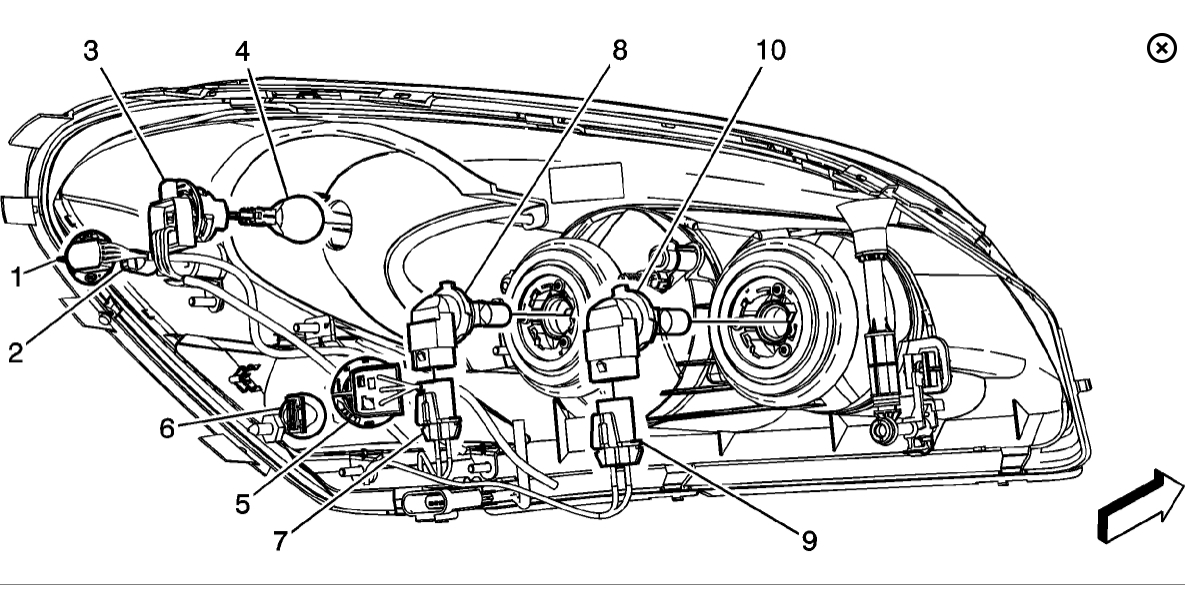

I have the CXL model. I replaced the high beam with a pair of HID bulbs and now they will not turn on.
+1
  • 110,194 POSTS
Hi and thanks for using 2CarPros. Com.
The vehicle is designed to use a halogen bulb and not HID. These two bulb types work in very different ways. Replace the bulbs with the same type you removed and they should work. If they do not, let me know.
DCVZFOX
  • 13 POSTS
I did replace the bulb with the same number. Which is 9005 and I could not seem to get them to come on.
  • 110,194 POSTS

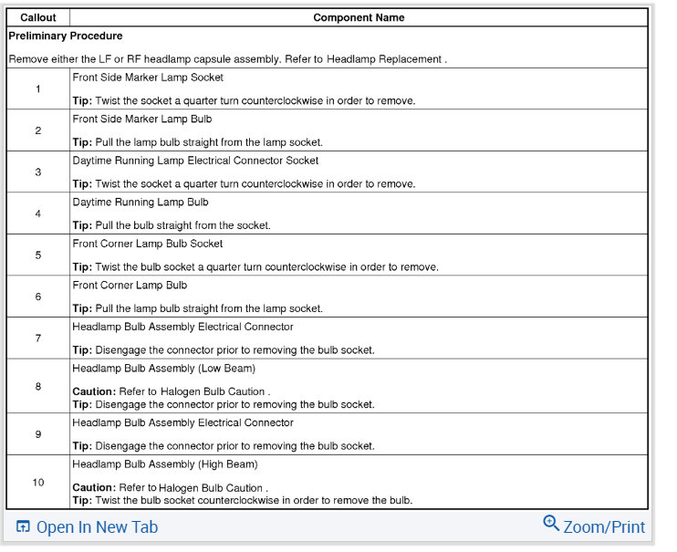

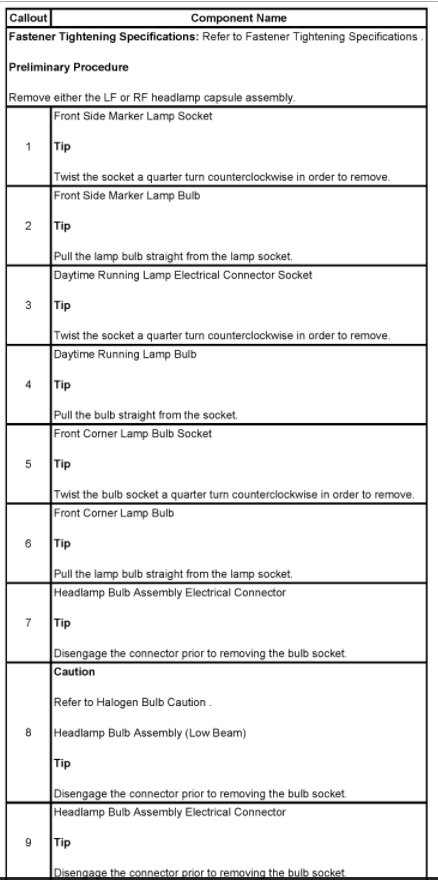

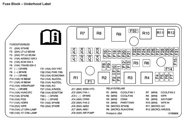

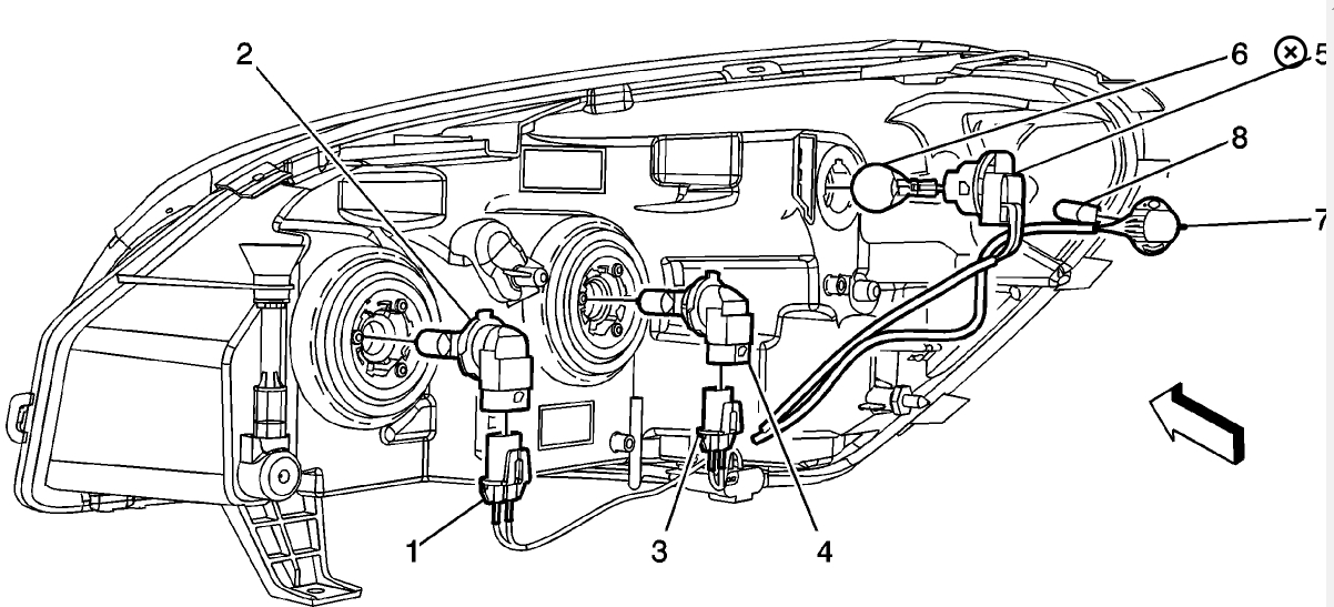

Have you checked to see if there is power to the light socket? Also, have you checked the fuses under the hood? Check fuses 10 and 11 under hood. They are specifically for high beam (left and right).
See the two attached pictures.
Let me know what you find.
DCVZFOX
  • 13 POSTS
I replaced the fuses with 20 amps because that is what the instructions said then just to make sure I plugged the old halogen bulbs in and they light right up.

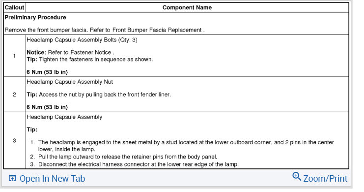

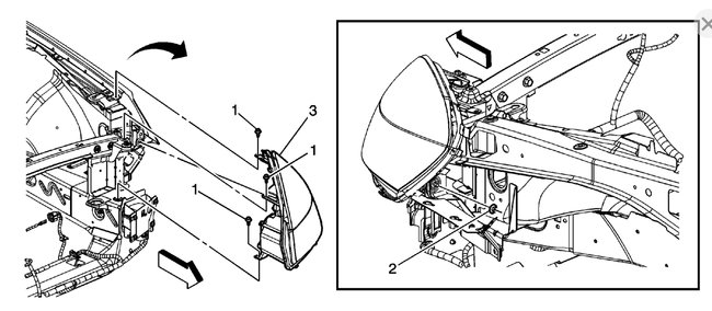

How do you remove a Buick Lucerne CXL headlight assembly in order to change the low beam bulbs?
FACTORYJACK
  • 4,159 POSTS

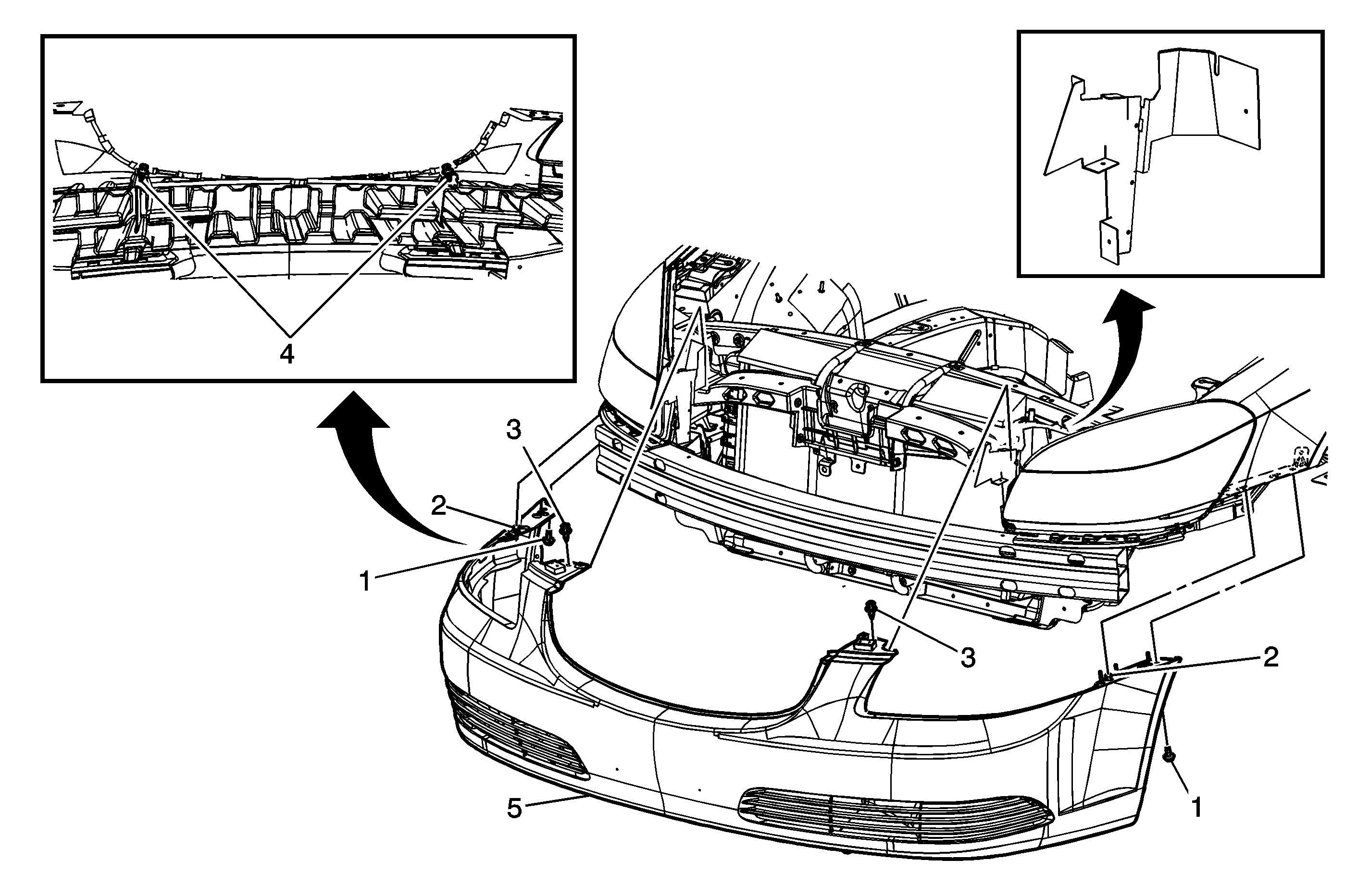

As with a lot of the vehicles lately, you need to remove the front bumper fascia.
Here are the steps: Front Bumper Fascia Replacement and some diagrams (BELOW)
†Remove front compartment sight shield. Refer to Front Compartment Sight Shields Replacement.
†Remove the front retainer from the wheelhouse liner. Refer to Front Wheelhouse Liner Replacement.
†Remove fascia grille. Refer to Fascia Grille Replacement.
†Remove the retainers from the air deflector. Refer to Front Air Deflector Replacement.
1- Front Fascia Bolt (Qty: 2)
Notice: Refer to Fastener Notice in the Preface section.
Tighten
10 NÂ m (89 lb in)
2- Front Fascia Nuts (Qty: 2)
Tighten
10 NÂ m (89 lb in)
3- Front Fascia Retainers (Qty: 2)
4- Front Fascia Retainers (Qty: 18)
5- Front Fascia
Tip
†Disconnect the fog lamp electrical connectors.
†Pull out on the fascia to release the tabs on the energy absorber to the impact bar.
†Energy absorber is attached to the front fascia.
Preliminary Procedure
Remove the front bumper fascia. Refer to Front Bumper Fascia Replacement.

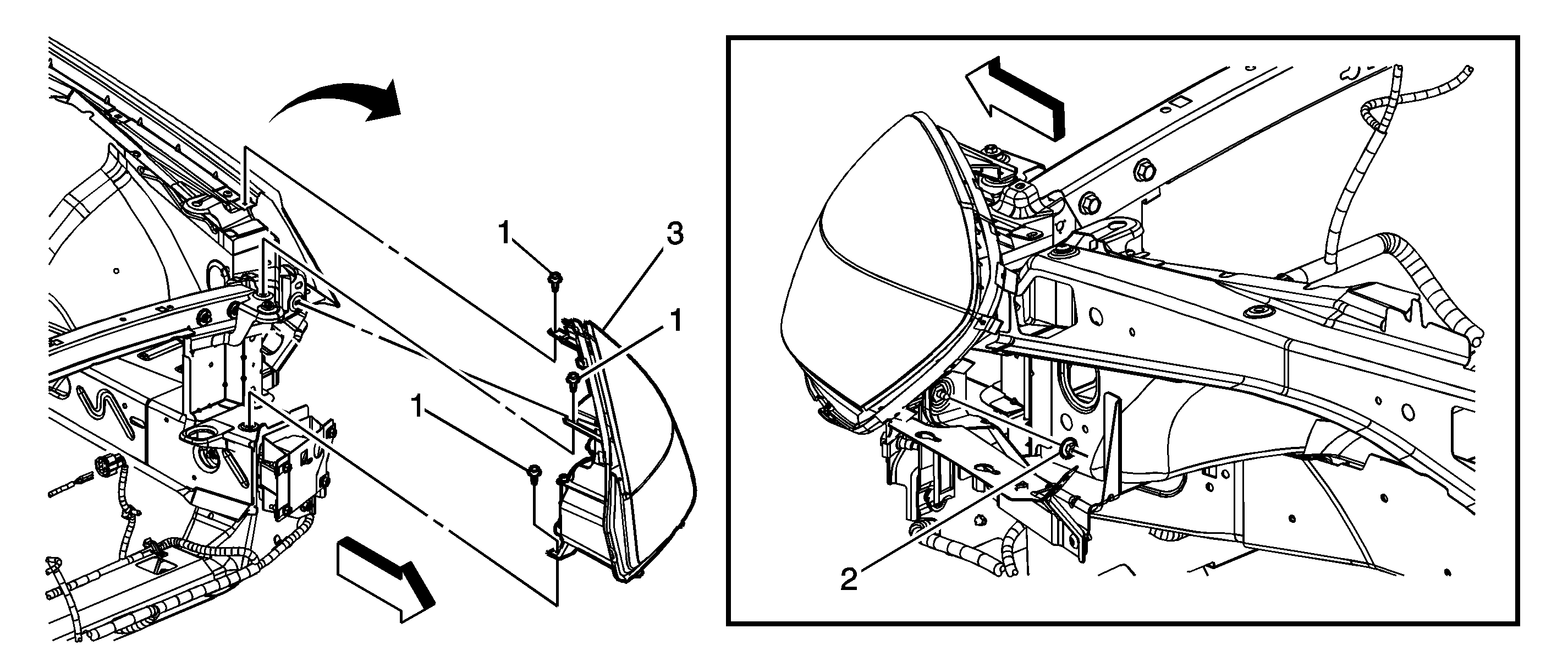

1- Headlamp Capsule Assembly Bolts (Qty: 3)
Tip
Tighten the fasteners in sequence as shown.
Tighten
6 NÂ m (53 lb in)
2- Headlamp Capsule Assembly Nut
Tip
Access the nut by pulling back the front fender liner.
Tighten
6 NÂ m (53 lb in)
3- Headlamp Capsule Assembly
Tip
†The headlamp is engaged to the sheet metal by a stud located at the lower outboard corner, and 2 pins in the center lower, inside the lamp.
†Pull the lamp outward to release the retainer pins from the body panel.
†Disconnect the electrical harness connector at the lower rear edge of the lamp.
