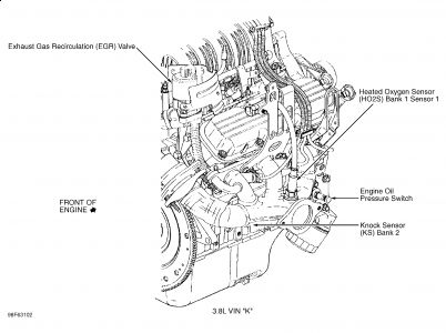

The normal oil pressure on my Buick LeSabre has been about 65 psi. About a month ago the pressure reading jumped to 85 psi, then a few days later jumped to 130 psi and has been at that reading ever since. I changed the oil filter, but that had no effect. There are no other symptoms - there is not even a warning light about the high pressure - the display just reads "normal". What could be causing this? Could it be the oil pressure sensor? When the engine is not running and I turn the key to "on" but don't start the engine, the oil pressure reads "0". Once the engine starts, the pressure goes right to 130 psi.

It could be the oil pressure sender or the oil pump pressure relief valve is stuck here is a guide that can help you fix it.

Electronic gauge all of a sudden shows 300 as oil pressure (but also says"normal"). With engine off shows 0 (zero). I'm going to try an oil change with new filter. What other causes would show this increase in gauge oil pressure. P.s. the car's running fine.

Faulty oil pressure sender
