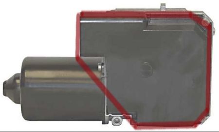

I think I am having problems with the wiper sensor. The wipers go on and off by themselves, with no ryme or reason. I have already changed motor, and it helped for awhile. Where is the sensor for the wipers? And what would other problem would cause them to do this? I had to remove the fuse as a temp fix! Thanks

You probably have a bad pulse board. It probably came with your wiper motor...usually does.
https://www.2carpros.com/forum/automotive_pictures/30961_xpul_1.jpg
It would also explain why the problem was temporarily better.
