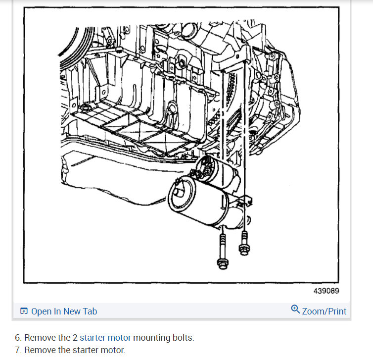

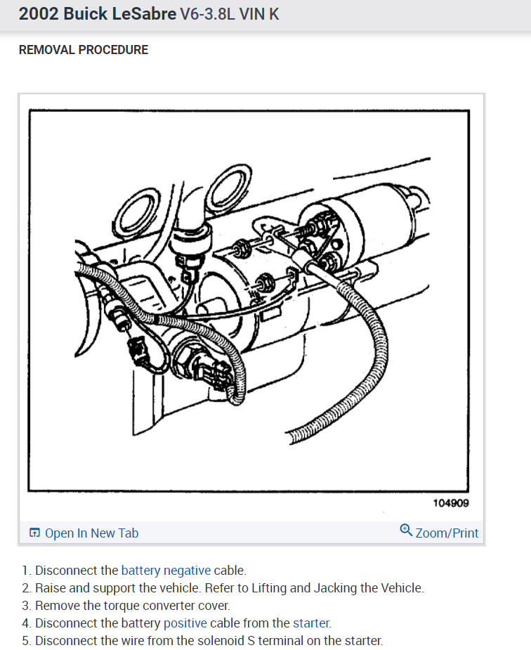

My starter makes a whining noise when it cranks. The mechanic has put 4 new starters and 2 new flywheels. I then had the old starter rebuilt and it still makes the same noise. Can you please help?
Sunday, March 7th, 2010 AT 6:25 PM
11 Replies
  • 75,992 POSTS
Hi Dossie Lee

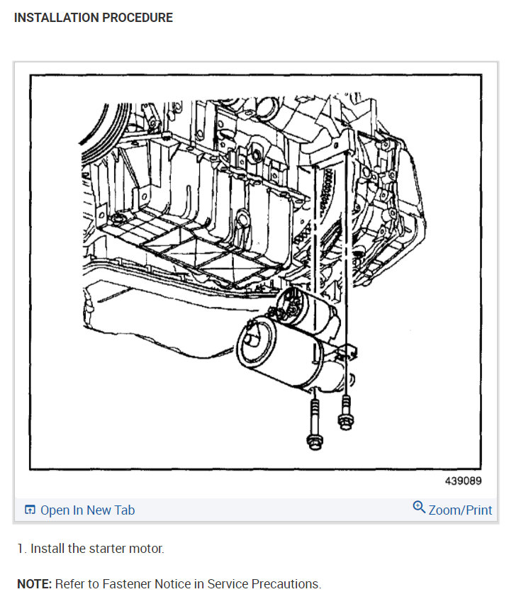

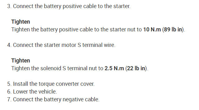

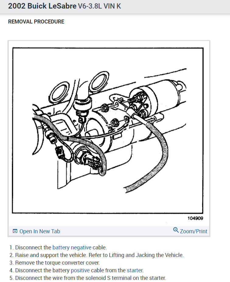

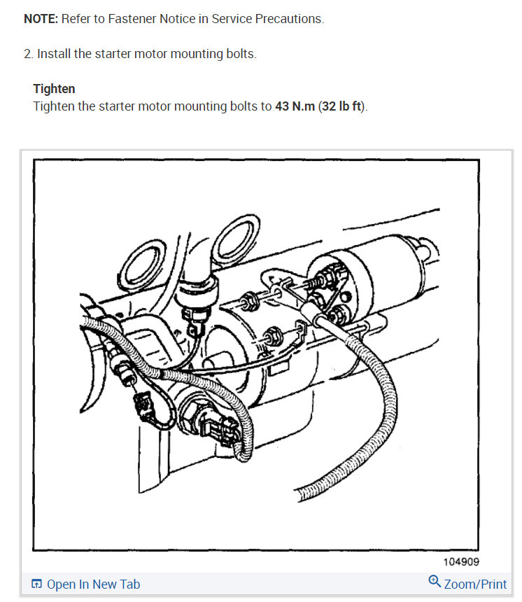

If the crankshaft is not bent, this is common if a cheap starter is used I would suggest and AC delco unit here is a guide to help walk you through the steps with the instructions in the diagrams below to help you on your car.
Check out the diagrams (Below). Please let us know what you find.
Monday, March 8th, 2010 AT 5:13 AM
DOSSIE LEE
My mechanic had already checked the crankshaft and the starter I took the starter to a starter repair shop. The only signs of any wear was the gear that engages the flywheel they replaced it. Still the same whine. He has about to give up on it when I handed him the AC delco unit worked perfect! Thank you.

If this is still the mounting style that uses two long bolts that go straight up through the nose into the block, add a shim. Most replacement starters come with one shim included.

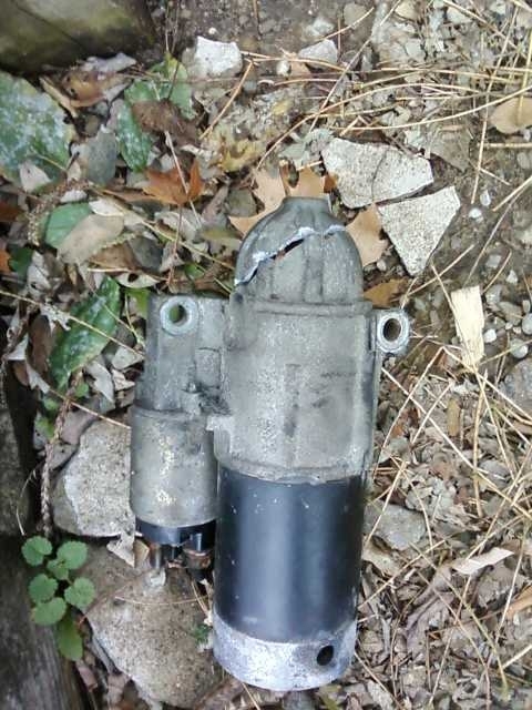

I just put on a starter. The last one had a broken piece on the end. Then I started the car, and guess what, this 2nd one broke! Help?
Wednesday, November 18th, 2020 AT 8:11 AM (Merged)
  • 108,269 POSTS
Make sure the starter is fully seated and tight. If there were shims on the original starter, make sure to use them. Finally, make sure the flywheel is tight and not damaged and the engine is free to turn.
