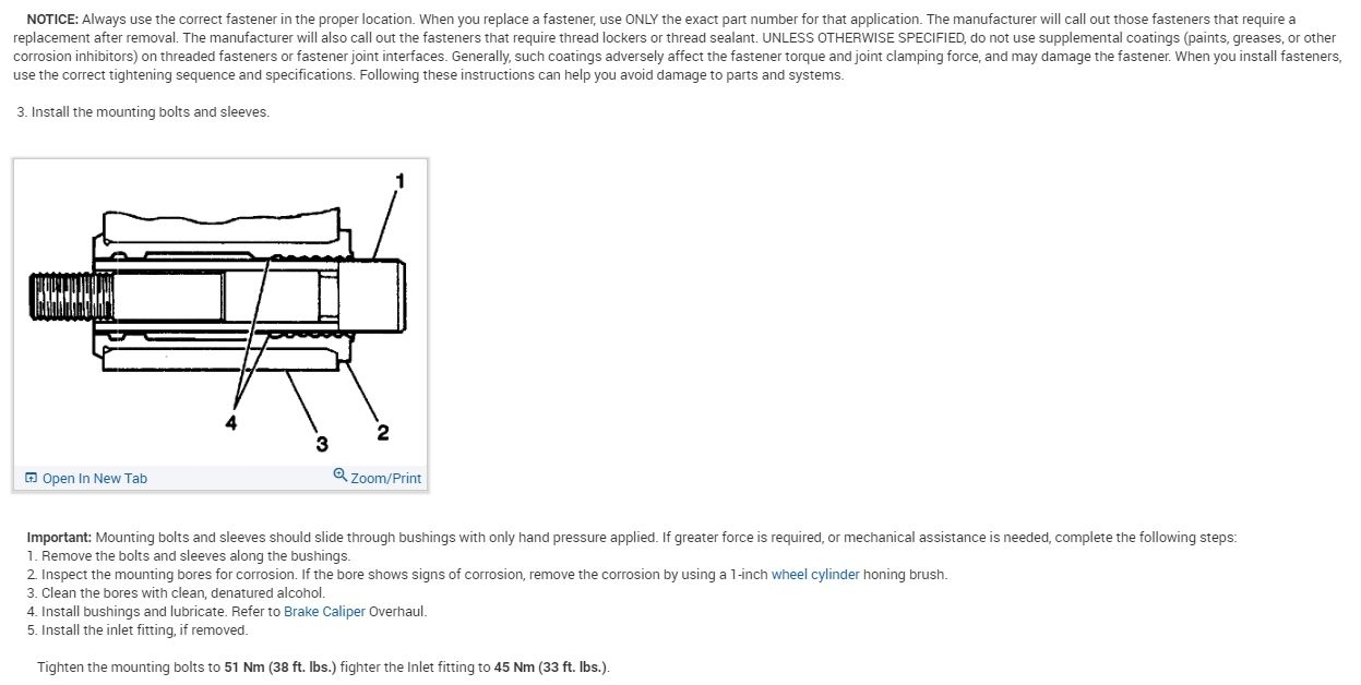

Brakes problem
Are the front calipers attached by two threaded bolts, or by one threaded bolt and a pin, to the yoke?
Friday, January 22nd, 2010 AT 11:21 AM
HMAC300
  • 48,601 POSTS
They are attached by two bolts that the caliper is able to slide on. There are spacers built around the bolts themselves. They are available at auto parts stores.
See the picture below, it shows the bolt/sleeve
