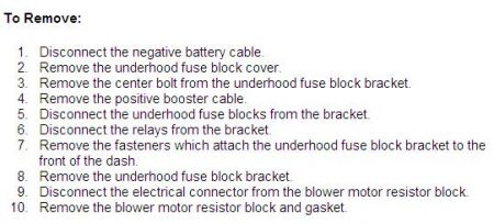

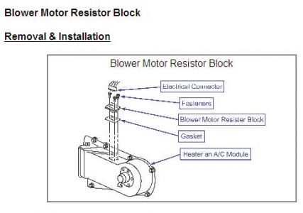

Were is the blower motor resistor located.

Saturday, December 19th, 2009 AT 10:00 AM
