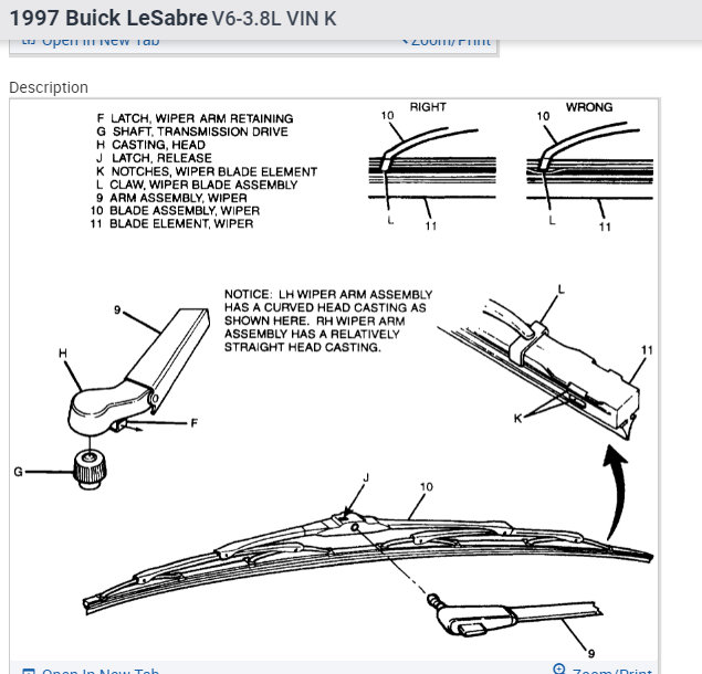

The windshield wipers on one side chatter, vibrate, hop and skip when they are on, what could this be?

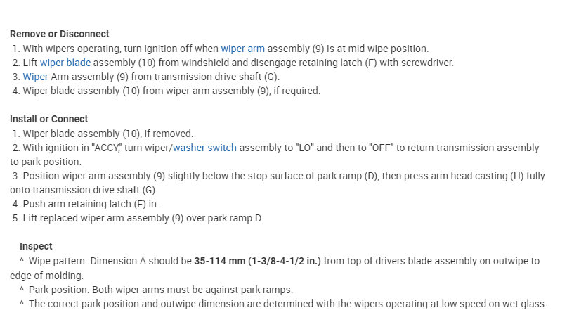

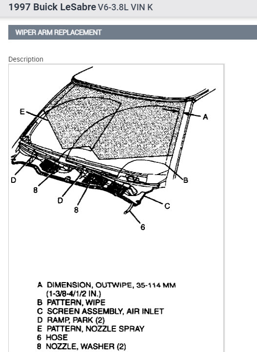

This could be due to bad wiper blade or the spring on the wiper arm is too weak to have enough pressure on the wiper blade to make smooth contact as it sweeps back and forth.
Make sure there is no dirty or debris stuck under the wiper blade as that can add more friction and create this type of issue as well.
https://www.2carpros.com/articles/how-to-replace-windshield-wiper-blades
