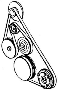

1997 Buick Lesabre putting serpentine belt on
1997 BUICK LESABRE
15,800 MILES • 6 CYL • 2WD • AUTOMATIC
MELISSACFRAME
What do you have to take off to put the new belt back on

https://images.2carpros.com/forum/automotive_pictures/12900_belt_7.jpg
REMOVAL Remove the following components. The engine mounting bracket lower nut. The engine mounting bracket lower stud. The engine mounting bracket lower spacer. Remove the belt. INSTALLATION Install the belt. Refer to Engine Mount in order to install the following components: The engine mounting bracket lower nut. The engine mounting bracket lower stud. The engine mounting bracket lower spacer.
