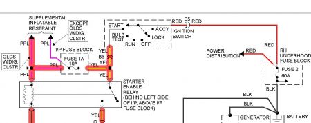

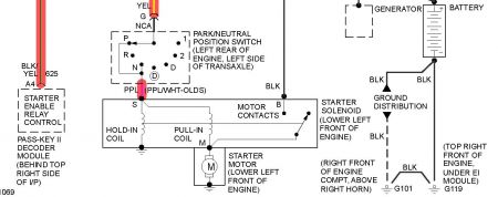

The battery is good and the starter works. Also 12.4 volts is getting to the starter, but when you turn the key nothing happens. How do I test the safety netural switch and the ignition switch to see if these parts are bad.
Saturday, September 11th, 2010 AT 7:33 PM
  • 75,992 POSTS
If you can use a voltmeter to read of voltages-you can find the problem thru the Start Circuit EWD below
https://www.2carpros.com/forum/automotive_pictures/12900_s1_67.jpg
https://www.2carpros.com/forum/automotive_pictures/12900_s2_59.jpg
