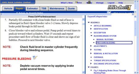

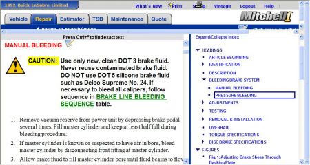

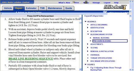

My brake light came on and the rear left wheel cylinder was leaking so I replaced it and bled it. My car has disc brakes in the front and drum brakes in the back. Now only the front left brake is working and there is nothing wrong with the other three. I have bled every brake and still only the front left works. What can I do to get the others working?

See manual bleeding below
