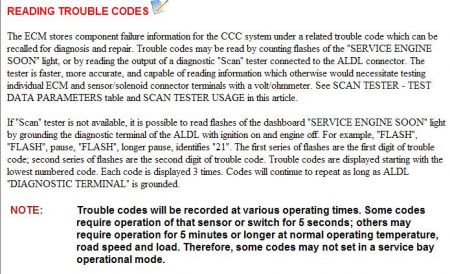

How do you pull codes on the car listed above and where can I get a list of the codes?

Let me know what code(s) you retrieve and I can give you the definition of it..
