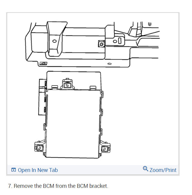

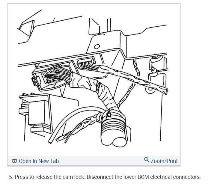

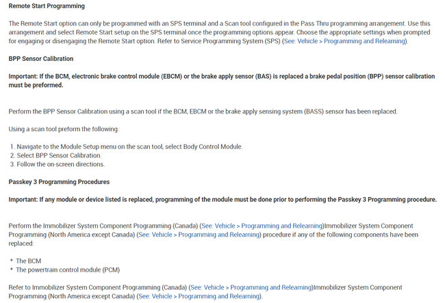

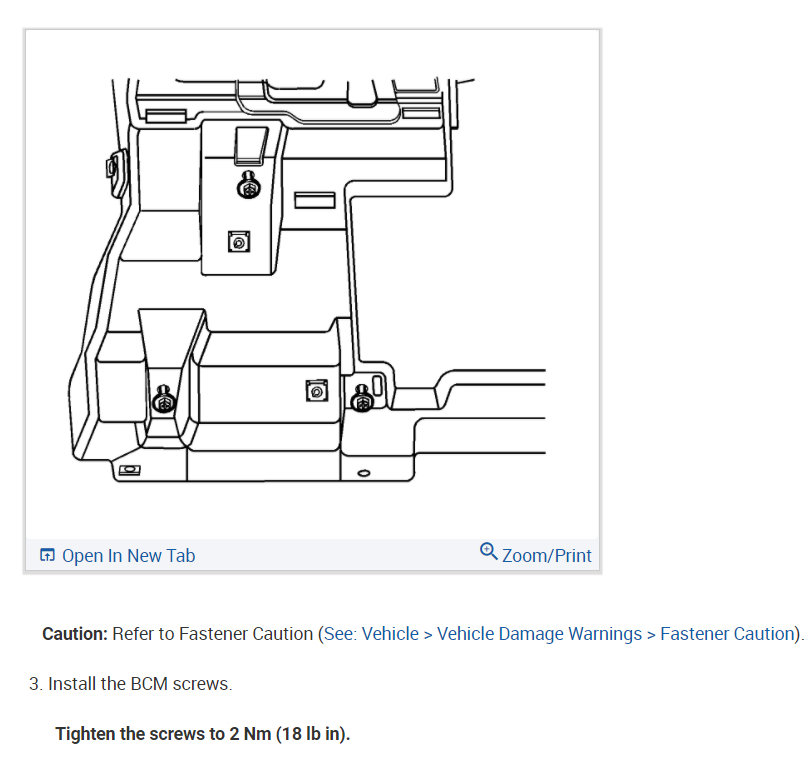

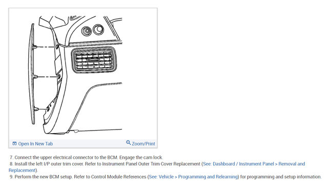

HMAC300
  • 48,601 POSTS

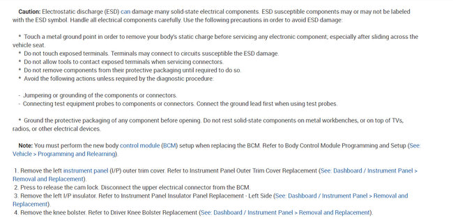

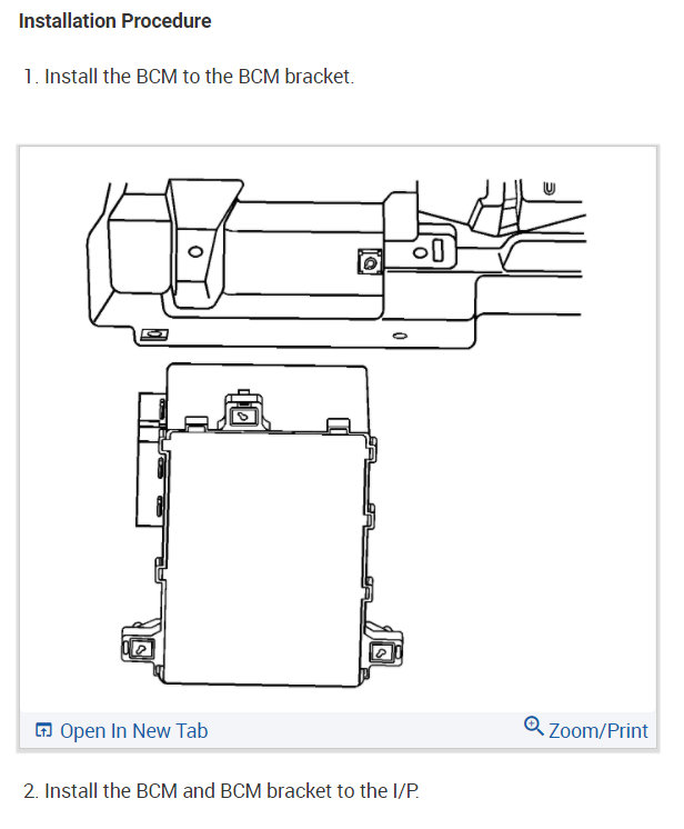

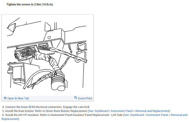

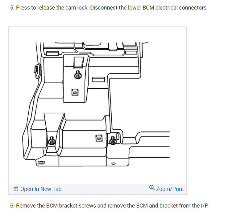

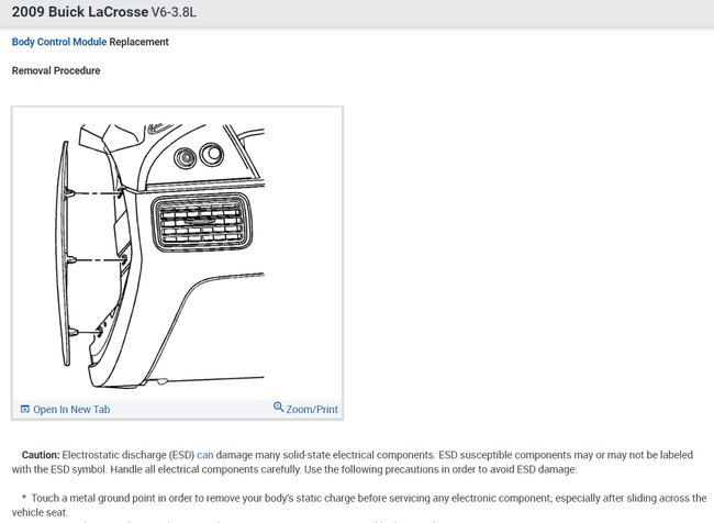

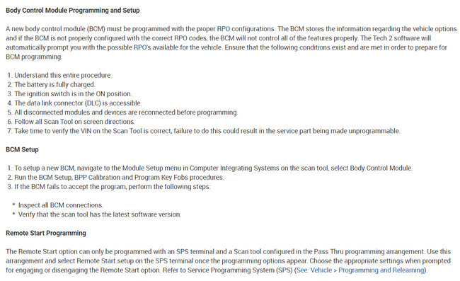

This is usually caused by a bad BCM but to be sure this video will show how to do a CAN scan which will confirm the issue.
https://youtu.be/InIlnsjOVFA
Also I have included the BCM replacement instructions in the diagrams below. Check out the diagrams (Below). Please let us know what happens. You can get a rebuilt unit that is programmed already.
