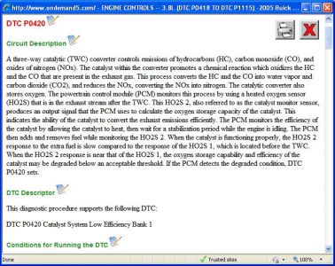

The check engine light comes on with P0420 code. Regular system diagnostic test shows engine running clean. Freeze frame shows code being set only at idle, at 15 minutes and again at approximately 45 minutes. What is the cause and what is the fix?

First of all thank you so much for your donation. Most of the time that code is caused by a bad catalytic convertor the good news is it is probably covered by your emission's warranty. What engine do you have the 3.6L or the 3.8L?Let me know so I can get you the correct information.

The car has the 3.8 engine. I forgot to include: Code #P0420 Catalyst System Low Efficiency Bank 1. Some one had suggested to me that an oxygen sensor could be the culprit since the mileage is only 43,600. The real mystery is it only triggers at idle. Thanks, Lou

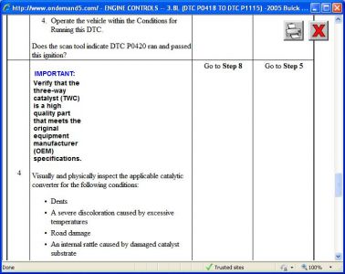

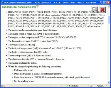

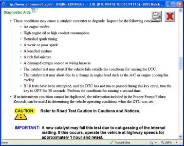

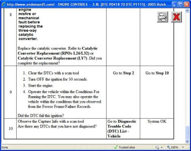

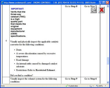

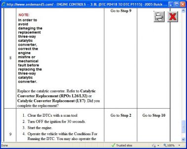

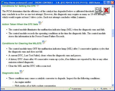

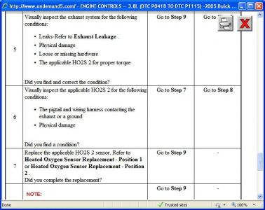

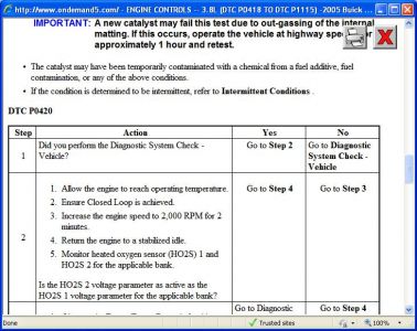

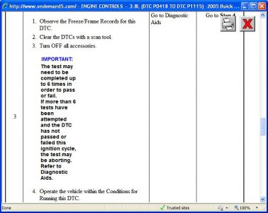

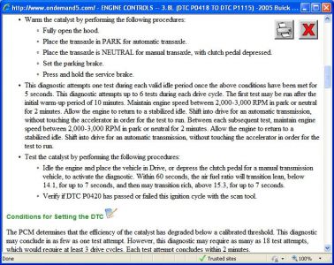

There is the trouble tree for that code it's most likely the cat even with the low mileage i have seen cat's fail with even lower mileage then that.When your car idle's it has less exhaust going thru the cat and that mean's the cat has a colder temp so the code is more likely to set at idle.
