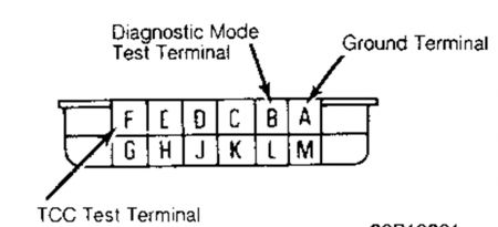

If it's an ABS problem read the codes this way:
ABS DIAGNOSTIC CODES 1. With ignition off, ground ALDL connector (pin H), located under dash on driver's side of vehicle. Turn ignition switch to "RUN" and count "ANTI--LOCK" lamp flashes. This is the first digit of the trouble code. The lamp will pause (remain off) for 3 seconds then begin flashing the second digit of the code. If lamp turns on for 4 seconds then turns off, no trouble codes are present, return to FUNCTION CHECK. 2. Leave ignition in "RUN" position. After the first code has been displayed, record code and unground ALDL. Ground connector a second time and repeat counting flashes as in step 1). This will be the second code. Record second code and repeat step 2) until there are no more codes. 3. Repair indicated problem before clearing codes. All codes must be displayed before EBCM will clear memory. Drive vehicle above 18 MPH. Display codes and repeat step 3) until no more codes display.
https://www.2carpros.com/forum/automotive_pictures/62217_ALDL_7.jpg
Jump A to H and count the flashes,
Cross these two terminals , then turn the key on. Count the flashes, a 22 will flash as 2 flashes then a short pause, then 2 flashes, if more than one code is stored, the pause will be longer. The codes will display three times and end with 12. Write them down and post here. This connector is right under the left side of the dash...

Ok, this particular model does not have ABS.
I will get the codes for you asap. Am currently at work, and cannot access my vehicle.

Well I have to say this information didn't help much, as every step quoted I have already done twice. I have now done it three times.
No change in the issue first written about. And the codes thing, don't have ABS brakes. Not going to give me ABS brake codes
