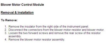

SPEED CONTROL - 1ST 2 SPEEDS DO NOT WORK.
I SUSPECT A RESISTOR CONTROL BOARD.
WHERE IS IT LOCATED? THANKS!
