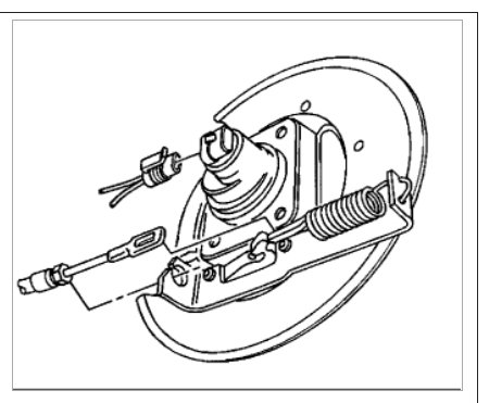

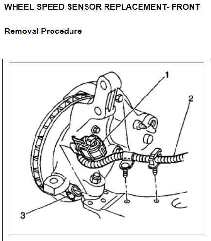

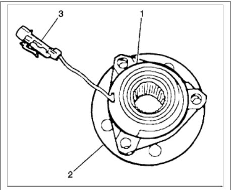

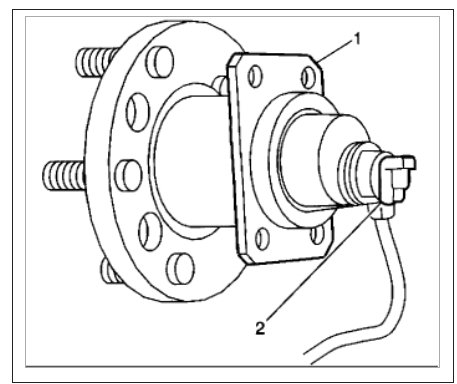

I was informed that I needed to replace my wheel speed sensor. However, I am cannot find where this is located in my car. Can you please tell me where it is located in my car?
Sep 18, 2009 at 3:21 PM
  • CERTIFIED EXPERT
  • 110,185 POSTS
Hello,.
Here is a guide to show you how to do the job.
https://www.2carpros.com/articles/how-to-replace-an-abs-wheel-speed-sensor
Here is how it will be done on your car (below) both front and rear.
