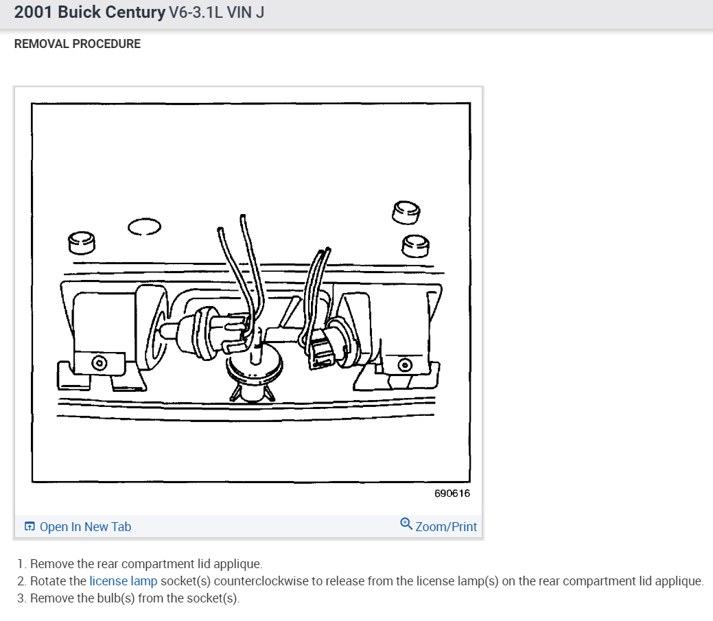

How to replace a license plate light bulb?
Monday, October 27th, 2008 AT 9:38 PM
11 Replies
  • 110,194 POSTS
Hi:
Here is the instructions and diagrams below to show you how to replace the license plate light bulb in your car. Check out the diagrams (Below). Please let us know if you need anything else to get the problem fixed.

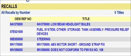

Also, it looks like you may have some recalls on your vehicle. The dealer may fix these for free. Please contact the dealer service department, give them the VIN number of your car and have them check on these to see if they apply to you.
https://www.2carpros.com/forum/automotive_pictures/248015_1999_Century_Recalls_1.jpg

How do you replace the license plate lamps
-1
Friday, February 8th, 2019 AT 5:51 PM (Merged)
  • 110,194 POSTS
From in the trunk, you need to remove the wing nuts holding the lens cover on the deck lid. Once they are off, you can remove the cover over the lights and access them.

It looks like there are about 7 larger bolts looking from underneah the trunk. Is the lens cover also covering the rear tail lights?
+1
  • 110,194 POSTS
Actually, the len assembly will come out as a unit and the bulbs will be accessable from behind it.
