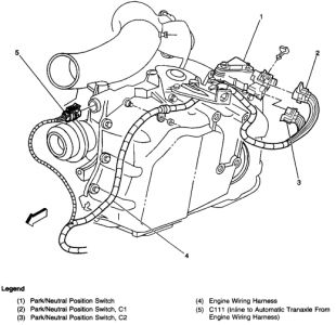

I need to know where and how to change the backup light switch

The backup light switch is incorporated into the Park/Neutral switch also know as the neutral safety switch. It's located on the top of the transmission and will have to be adjusted to neutral when replaced.
https://www.2carpros.com/forum/automotive_pictures/561653_Park_neutral_switch_00_Century_1.jpg
