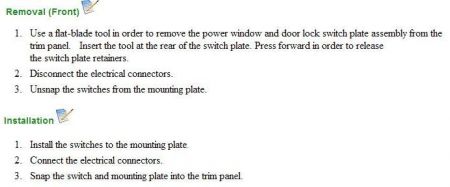

Can someone please tell me the procedure to remove and replace the 5-button window control switch in the driver's side armrest of my 1999 Buick Century? Thanks for any assistance!

https://www.2carpros.com/forum/automotive_pictures/261618_Noname_1429.jpg
https://www.2carpros.com/forum/automotive_pictures/261618_Graphic_265.jpg
https://www.2carpros.com/forum/automotive_pictures/261618_Graphic2_31.jpg
