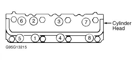

What is the torch pattern and poundage.

Torque for cylinder head bolts?
torque in 2 steps..
step 1 33 foot lbs.
step 2 additional 90 degrees
be sure to apply sealant to the bolts and follow sequence below
