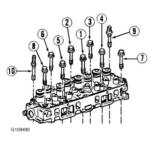

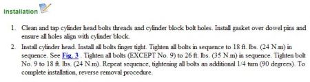

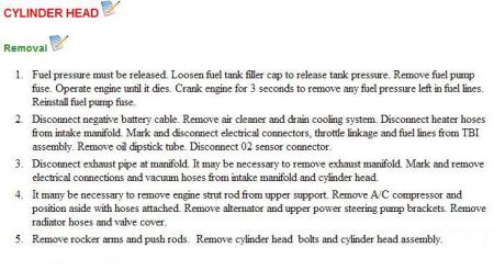

My '89 Century will not start. It pours out white smoke and "coughs" up from the intake when I try. The far left spark plug looks greasy around the gap andThe radiator water level has also gone down substantially . This leads me to belive the head gasket has blown. Since i cannot get anyone interested in fixing it, I am going to try it on my own. I have gotten to the head bolts; is there a specific method to untorque them and pull the head off ?

https://images.2carpros.com/forum/automotive_pictures/261618_Noname_928.jpg
https://images.2carpros.com/forum/automotive_pictures/261618_Noname2_248.jpg
FIG. 3
https://images.2carpros.com/forum/automotive_pictures/261618_Graphic_161.jpg
Sep 4, 2009 at 12:34 AM
