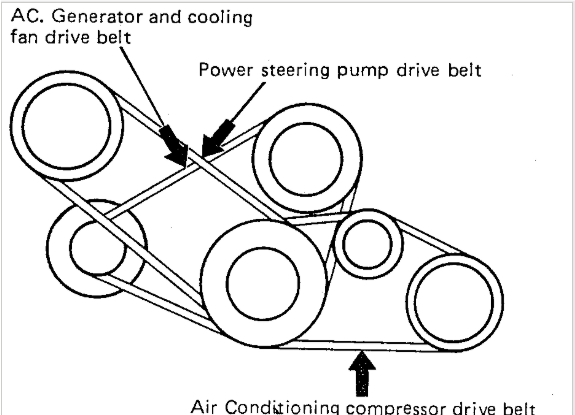

I have two belts that broke and or popped off. I need to know what belts I need to buy and where exactly each one goes

The auto part store will have the belt sizes, here is the routing so you can replace the drive belts. Check out the images (below). Let us know if you need anything else.
