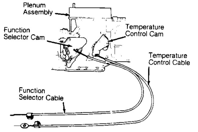

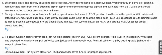

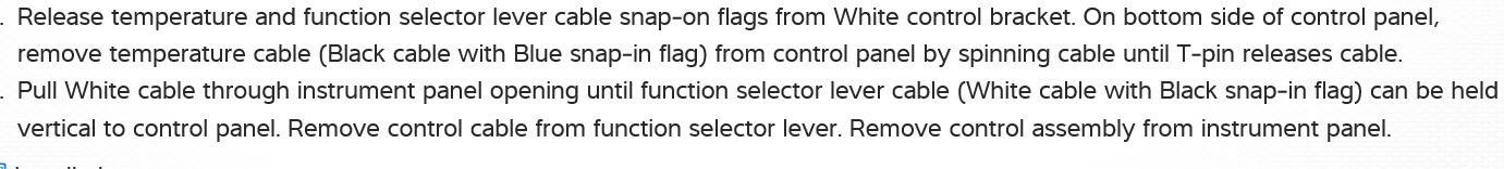

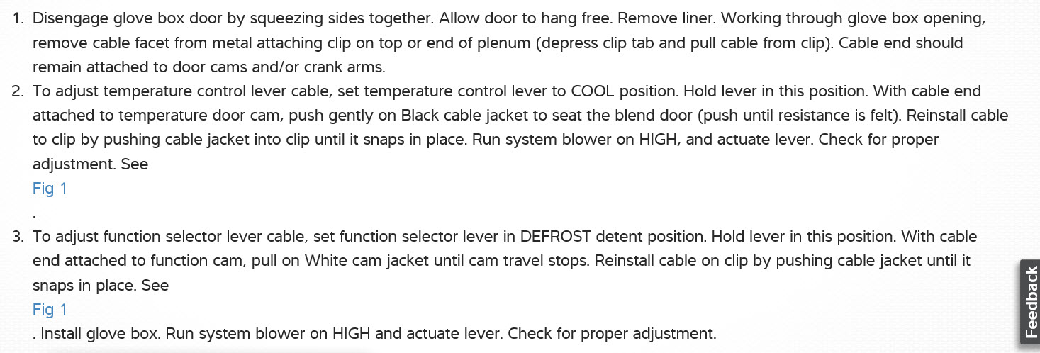

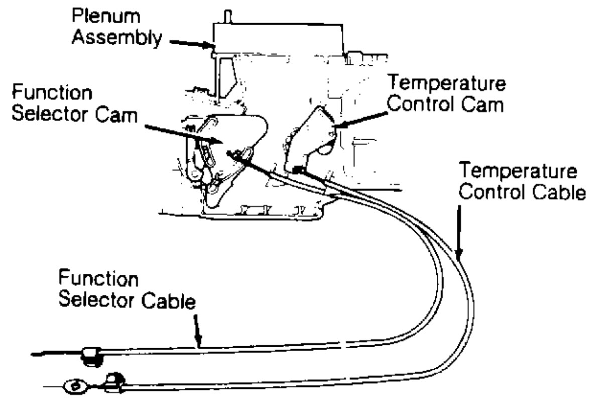

How do I replace an A/C and heater control cable?
Friday, March 18th, 2016 AT 5:24 PM
HMAC300
MECHANIC
48,601 POSTS
We really don't have instructions for that, but I've taken part of control head instructions for cable removal. It's best to take glove box out to access cable at heater then adjust it see pictures:
