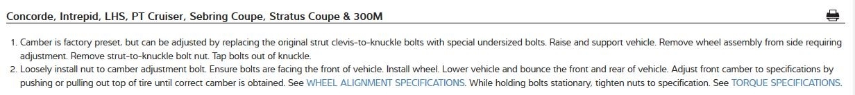

You will be bettor of replacing the tie rod with a new one, sounds as if the one fitted may be a problem. See picture regards alignment information.
