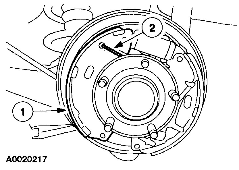

Here are the directions specific to your vehicle. The attached pictures correlate with these directions.
_____________________________________________________________
Brake Shoes
picture 1
Special Tool(s)
Removal and Installation
1. Remove the brake drum.
2. Use the Brake/Clutch/Service Vacuum to remove brake dust and dirt from the brake assemblies.

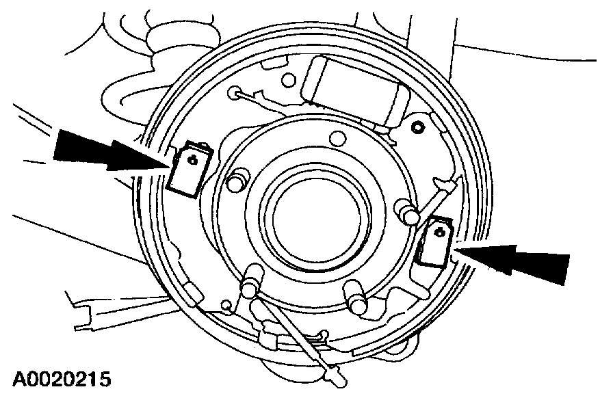

picture 2

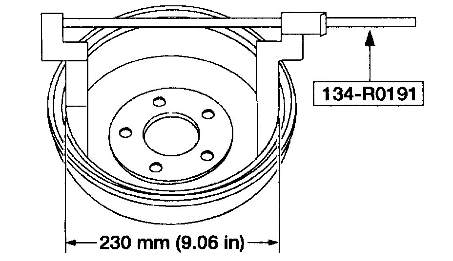

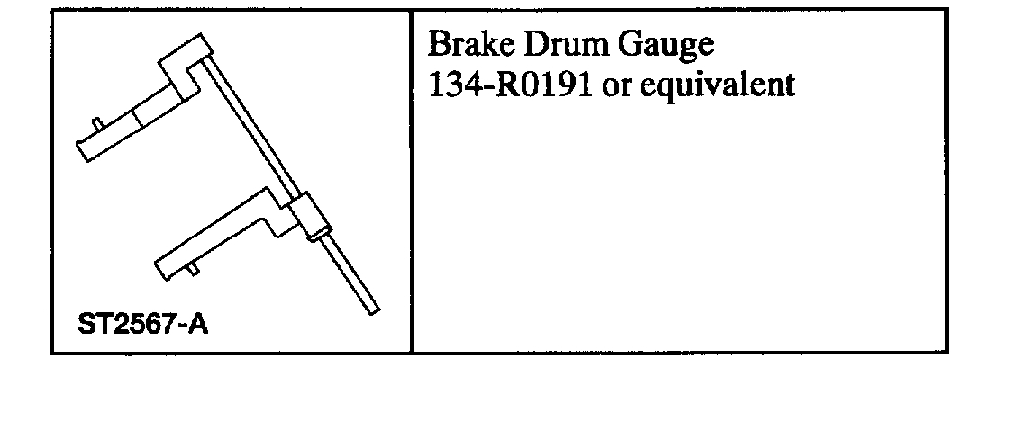

3. NOTE: If new rear brake shoes and linings are being installed, resurface the brake drums to remove glazing and to ensure an equal friction surface from side-to-side. Resurfacing will also correct out-of-round and bell conditions.
Using the special tool, measure the braking surface diameter. If the inside diameter measures more than the maximum specification shown on the outside of the brake drum, install a new brake drum.

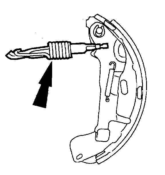

picture 3

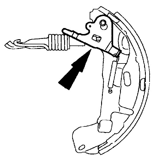

4. Remove the parking brake cable from the parking brake cable lever.

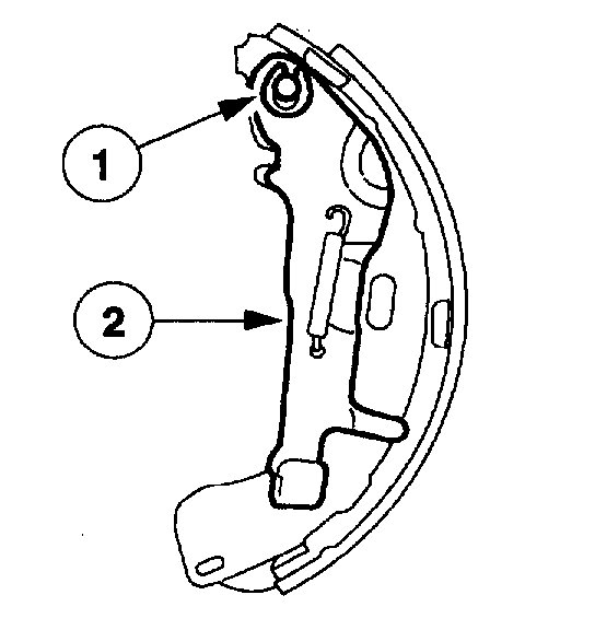

picture 4

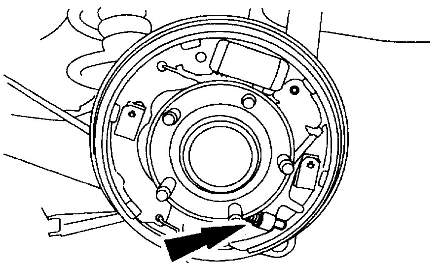

5. Remove the hold-down clips and pins.

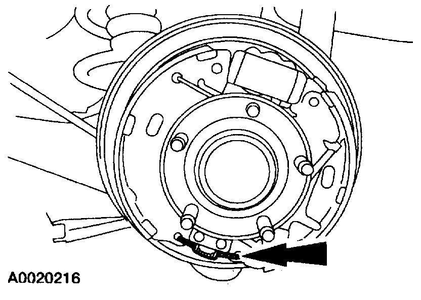

6. Remove the lower spring.

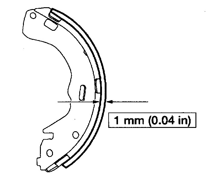

11. Inspect the rear brake shoes for minimum thickness above the backing plate, and install new as necessary.

Since there are no brake fluid leaks and you are not low on fluid, my first suspect is the rear brakes or rear brake adjustment. Please understand, not being there to check makes it difficult for me to determine the actual cause. A bad master cylinder can even be the cause. Therefore, I can't tell you if it is dangerous at this point. If you can, check the rear brake adjustment or have the rear brakes cleaned and adjusted to see if that takes care of the problem. A soft pedal can be an indication of problems that could be dangerous. Please be careful.
