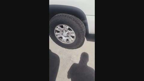

Okay first question my passenger rear tire is skipping or dragging when making a right turn at a very low speed. I put the rear axle up it was a little loose so I ended up replacing the seal. And the bearing cuz the differential look good. Took it for a test drive but still having still doing the same thing. I check all the brake lines nothing leaking. I plugged in my ob2 reader. I got 3 codes. It telling me all 3 wheel speed sensors are bad. So I replaced all there sensors. Can any help e I'm

I got my truck lifted up. I hoping you could till with the cover still on. But if I have to take it off I will. I sending a video if the tires spinning together. I reverse it. Than forward and I believe you could see when it slips and catches again

Thanks for the video but I need to se both tires at the same time, also have the truck in neutral, please take the video from the rear so I can see both, if the truck was in park during this test it is not he spider gears but you can still have limited slip differential. Ken

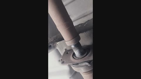

Ok I won't be able to get to it till Sunday. But I one I noticed my drive shaft center haves play to it and you see some chrome.

Yep, that center support is worn out and you need a new one but I don't think that can make the rear tires skid going around a corner. Thanks for the video. Let me know what happens this weekend.

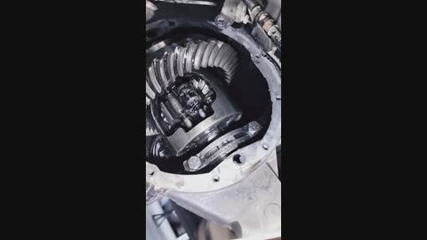

Ok I'm going to pop the pumpkin back open so you could look at

Lets see if the rear tires rotate the same way as well.

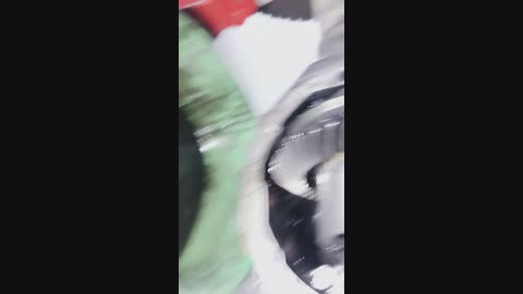

What's up ken? I'm sending 2 videos. Yes both tires are rotating. But when it's in reverse tires are harder to turn.

Hey, how are things going? So I see you do have limited slip to if it is broken it will not allow the rear tires to differentiate, (spin separately). So something happens on the videos I cant see everything, just the bottom half. But, while in neutral if the you spin the right tire clockwise and the left if spins the same way the diff is bad and is what the problem is.

So it's bad. Is it better getting the whole rear end

Yep, that is the way to do it, you might want to check ebay, I have had good luck with parts from there.
