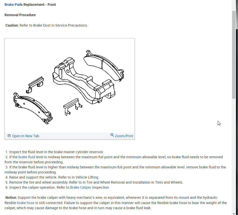

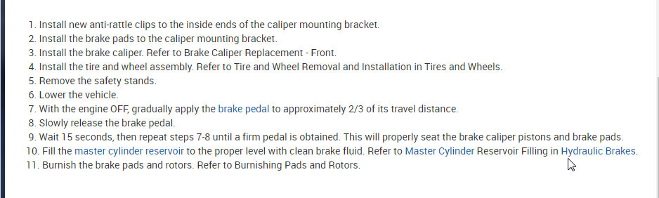

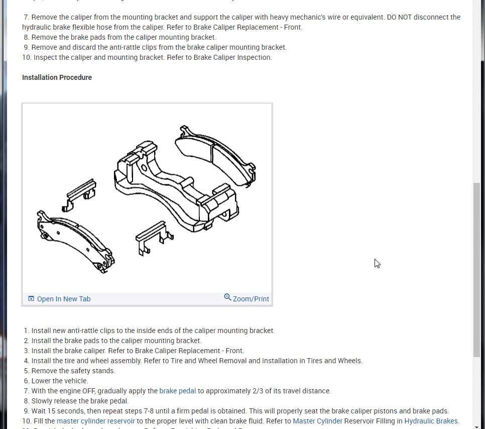

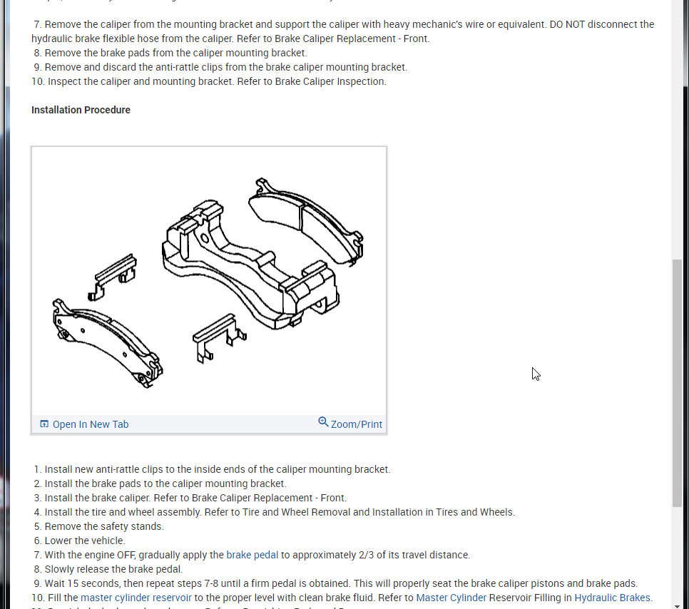

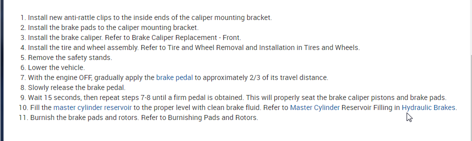

Brakes locking up it the front and grinding I think I need brakes
Monday, September 5th, 2016 AT 2:52 PM
MECHANIC
18,907 POSTS
Sounds like they are in need of replacement. Here are some guides that will help with this:
https://www.youtube.com/watch?v=1dB17cMwSOQ
Run through this material and let me know if there are questions.
Below you will find the process from the manual on how to replace the pads on this vehicle which will be helpful as well. Thanks
