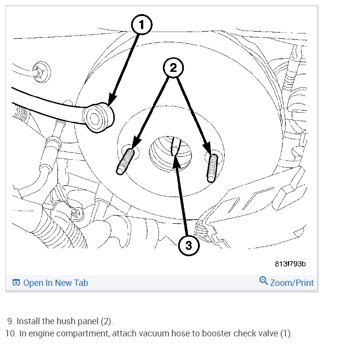

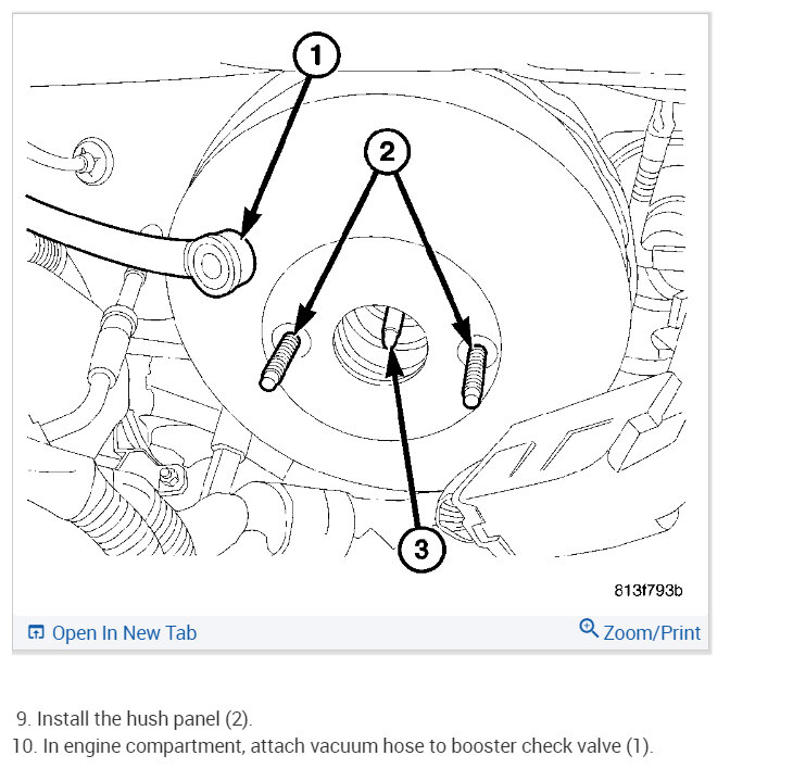

Yep, this happens when the brake booster adjustment is too tight not allowing the brake pedal to have a tiny amount of play. This can be done at the brake pedal clevis jam nut if it has one or if the booster push rod at the master cylinder, if the booster does not have any adjustments the booster is defective, and you need another. Check out the images (below). Please let us know what happens.
